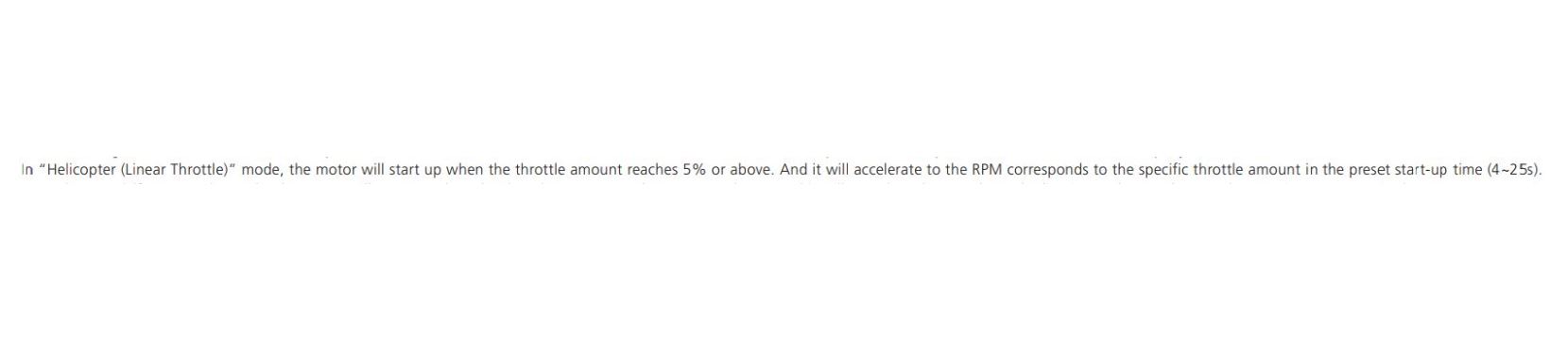

The value "start up time" work only with elf/store governor!!!and and has no effect on the sofstart of option 2 as the manual says(see attachment)
