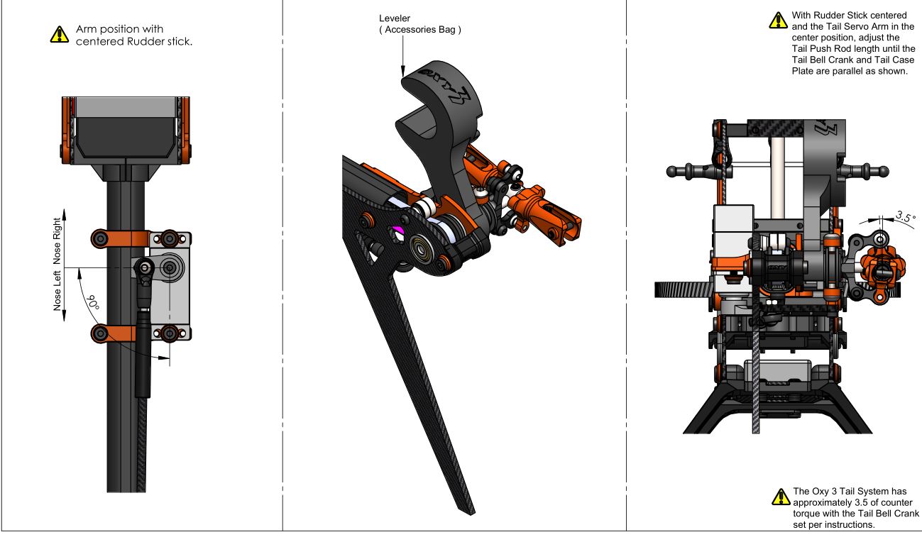

I'm sure the tail has been configured well, I'll put an attachment to make you understand how I configured it. Then they told me who saw the video that I don't have the soft start activated in the esc, and in fact in the HW 60 amp v4 I'm having difficulty activating it, because I excluded the governor, and on linear external governor i have found some thread that this same problem.

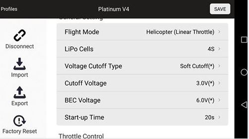

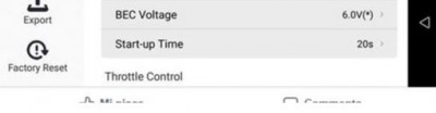

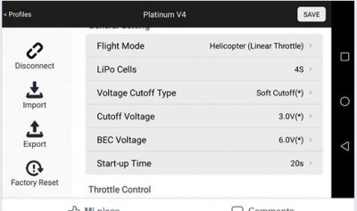

I can't understand where and how to set a slower spool up speed. The only value from the manual of my esc HW and on my app (with wifi module)that affects spool up is Start Up Time, see attchment

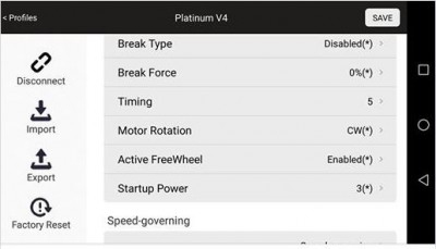

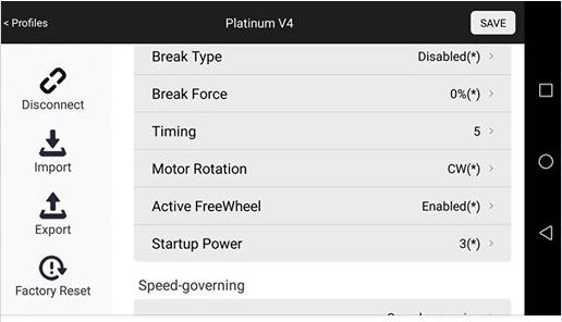

then there is another item start up force, but that concerns the strength of the engine at the start and that too is low(my value is 3 default)see attchment
