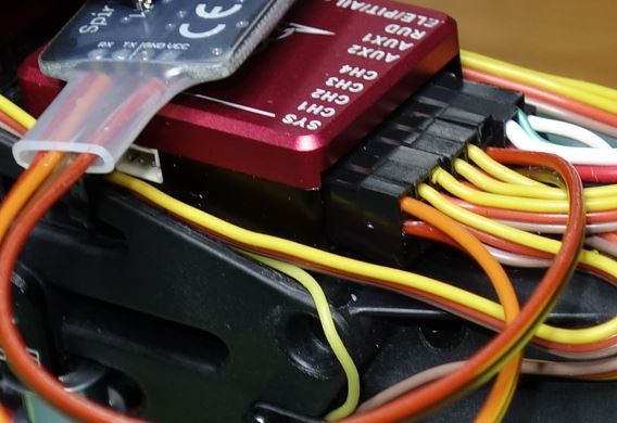

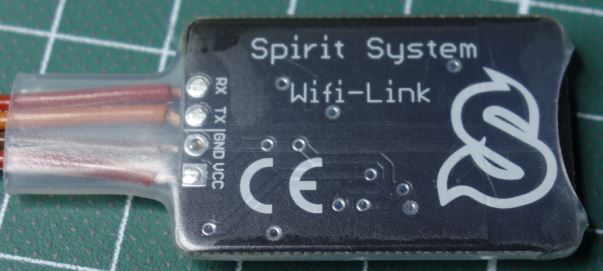

My Wifi-module has a blue PCB. I double checked the wiring again with your documentation. "RX wire must be always in the center pin of the SYS port."
It behaves as if the data cable is not connected.

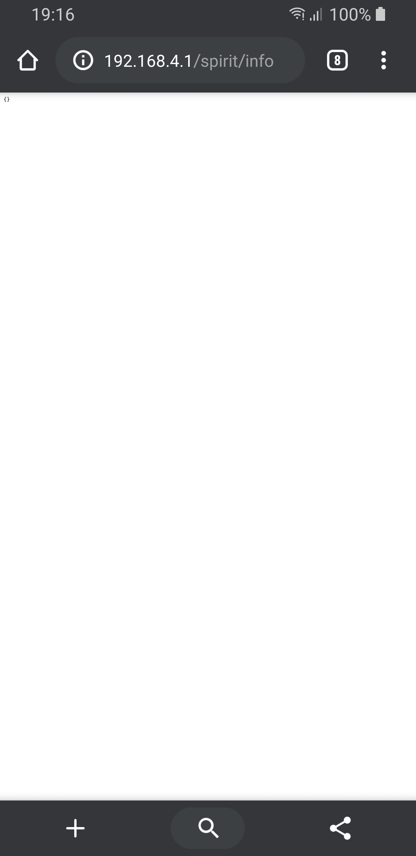

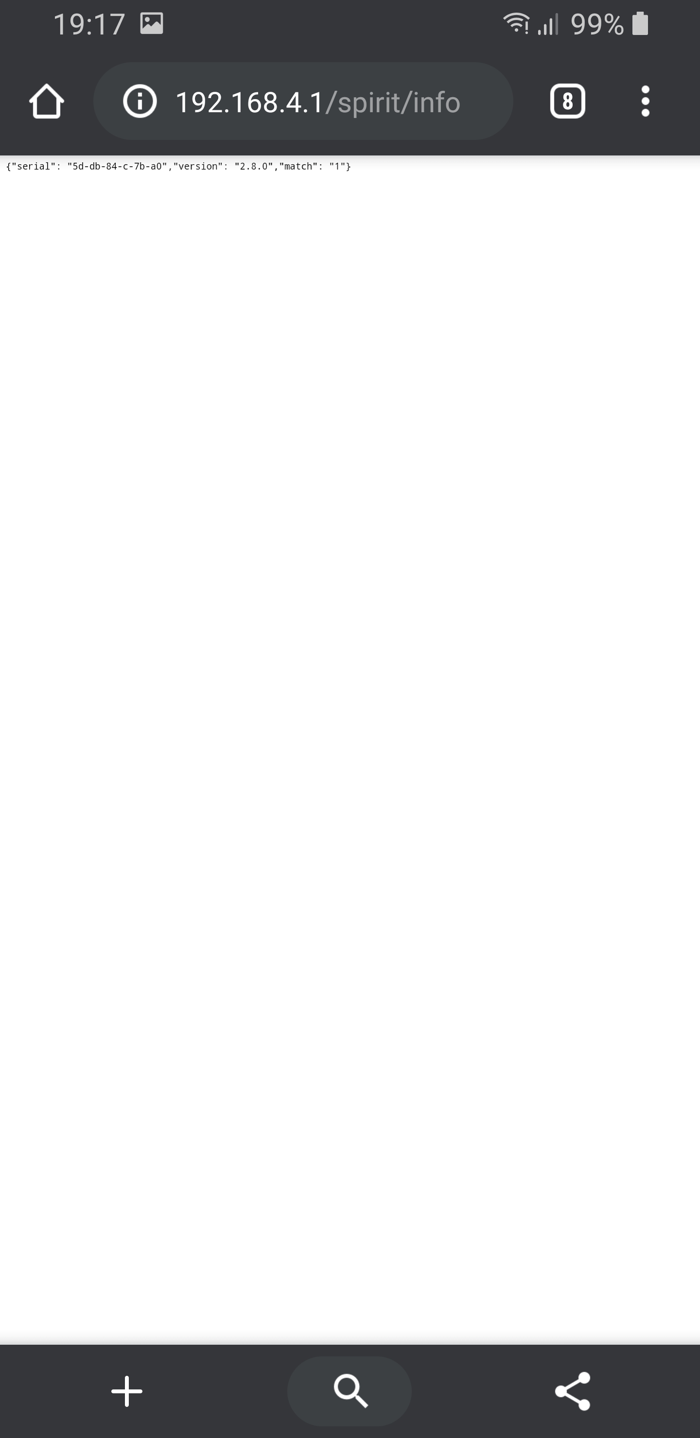

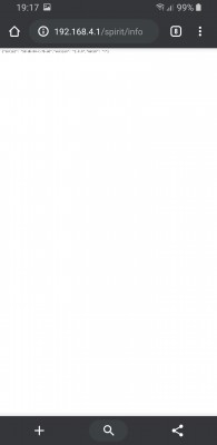

Could you please get output from this web address?: http://192.168.4.1/spirit/info

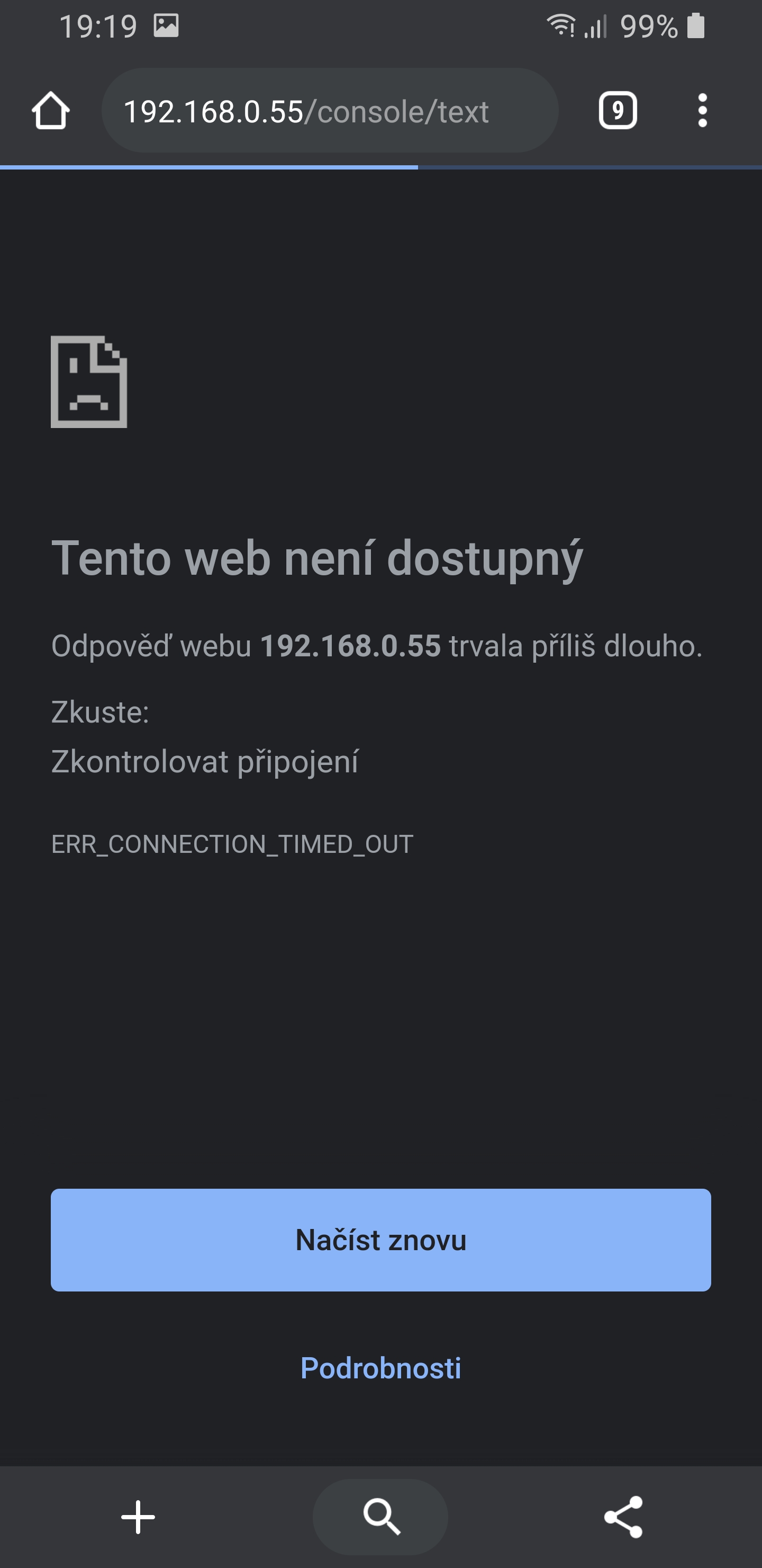

You should get some text also from this address: http://192.168.0.55/console/text

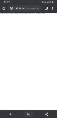

Here are printscreens. With the first adress I got almost blank page (I tried it many times and only once I got some text). The second adress didnt work at all.
I cant test it with other units cos its my first spirit and I bought it straight with wifi link and it havent worked even right out of the box so it would be weird to be damaged...especialy if more people have the same issue.
Posts: 13058

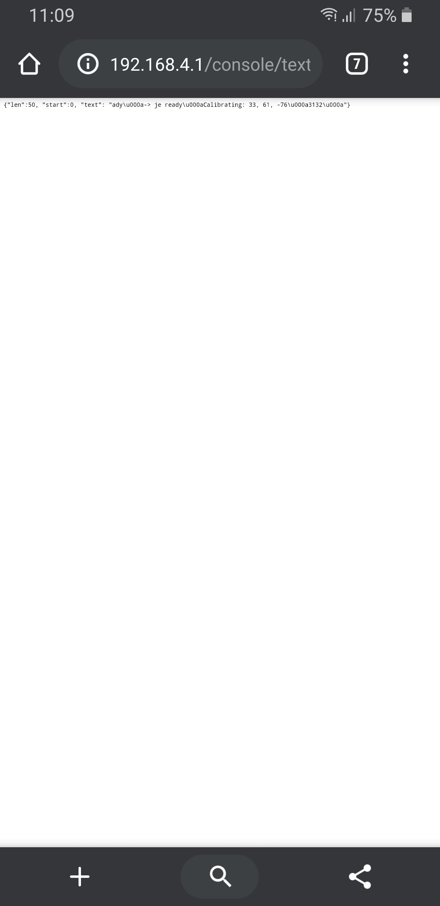

Sorry, second link should be http://192.168.4.1/console/text
martisek101
Posts: 20
Joined: Fri 31. Jan 2020 21:41:56
So here it is. :D

I get following messages:
{"len":38, "start":0, "text": "Calibrating: -22, 14, -19\u000a3131\u000a��EEE"}
