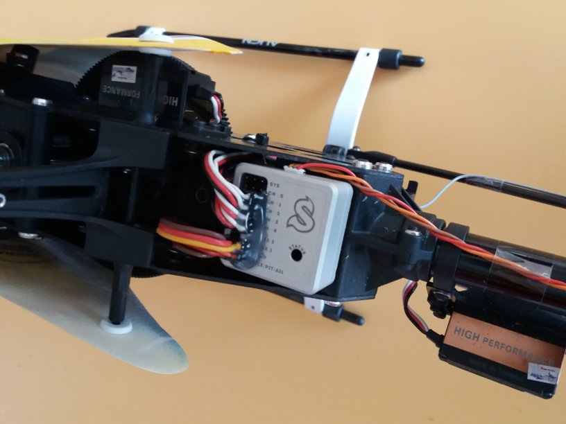

THE FINAL CHAPTER.
It happened again. Strange heli movements without command on my side etc.
Building on the previous experience I
1) changed the SBUS cable from FUTABA receiver to the Spirit PRo unit: connector fits tighter as compared to the old one
2) hot glued the connector zone of Spirit Pro unit (see picture) so to secure the connections while leaving the system connection available. The glue can be easily taken away mechanically if needed.
Three batteries flown without any problem: evil defeated.
Hope this helps in case someone experiences something similar

Apologies, I forgot the picture.
buttles
Posts: 157
Fingers crossed this is now sorted!!
Though I bet you wished you'd changed the SBus cable a little sooner? ;)
