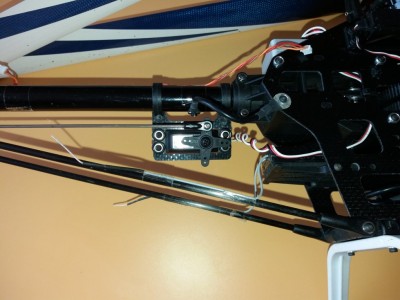

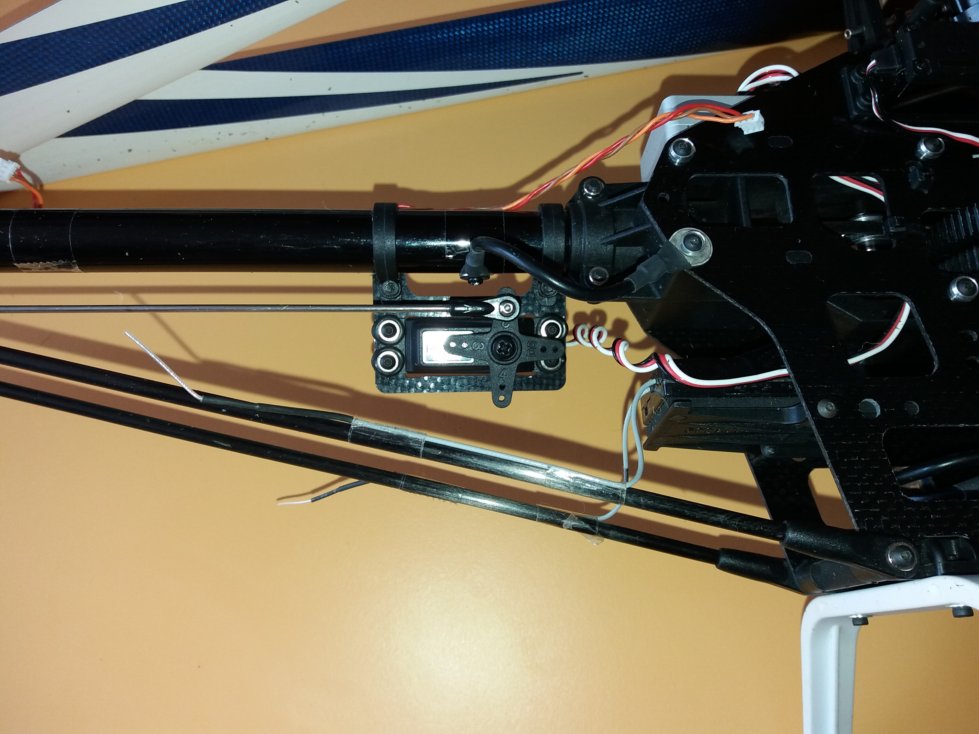

Hi
electrostatic discharges were my first guess, so I already put in electric contact tail boom (plastic) with carbon fiber heli frame,
obtaining no effect. In the attached photo you can see the black electric cable.
