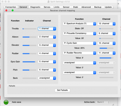

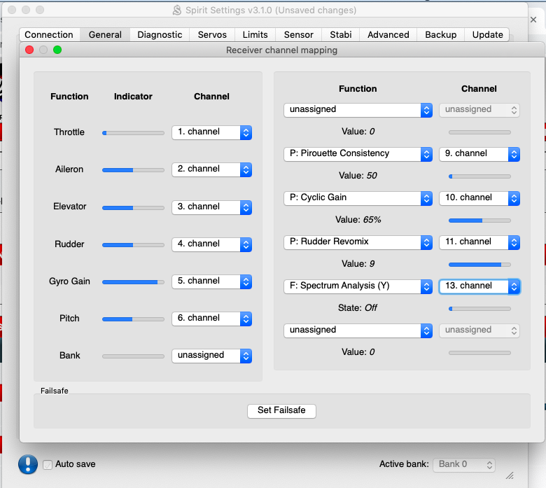

Okay, I discovered a bug in the software that seems to be causing the issue.
If I assign Spectrum Analysis Y to the upper right slot shown in the next photo, it works! I can see the In-Flight option.
Works.
Works.
But if I assign Spectrum Analysis Y to one of the lower slots I show in the next photo, it doesn't work.
Doesn't work.
Doesn't work.
Tomas, for some reason the actual drop-down location makes a difference.

Posts: 13058
You are right. This is really bug and will be sorted quickly in our upcoming 3.1.1 version.
Thank you very much!
I can send you fixed version immediately.
