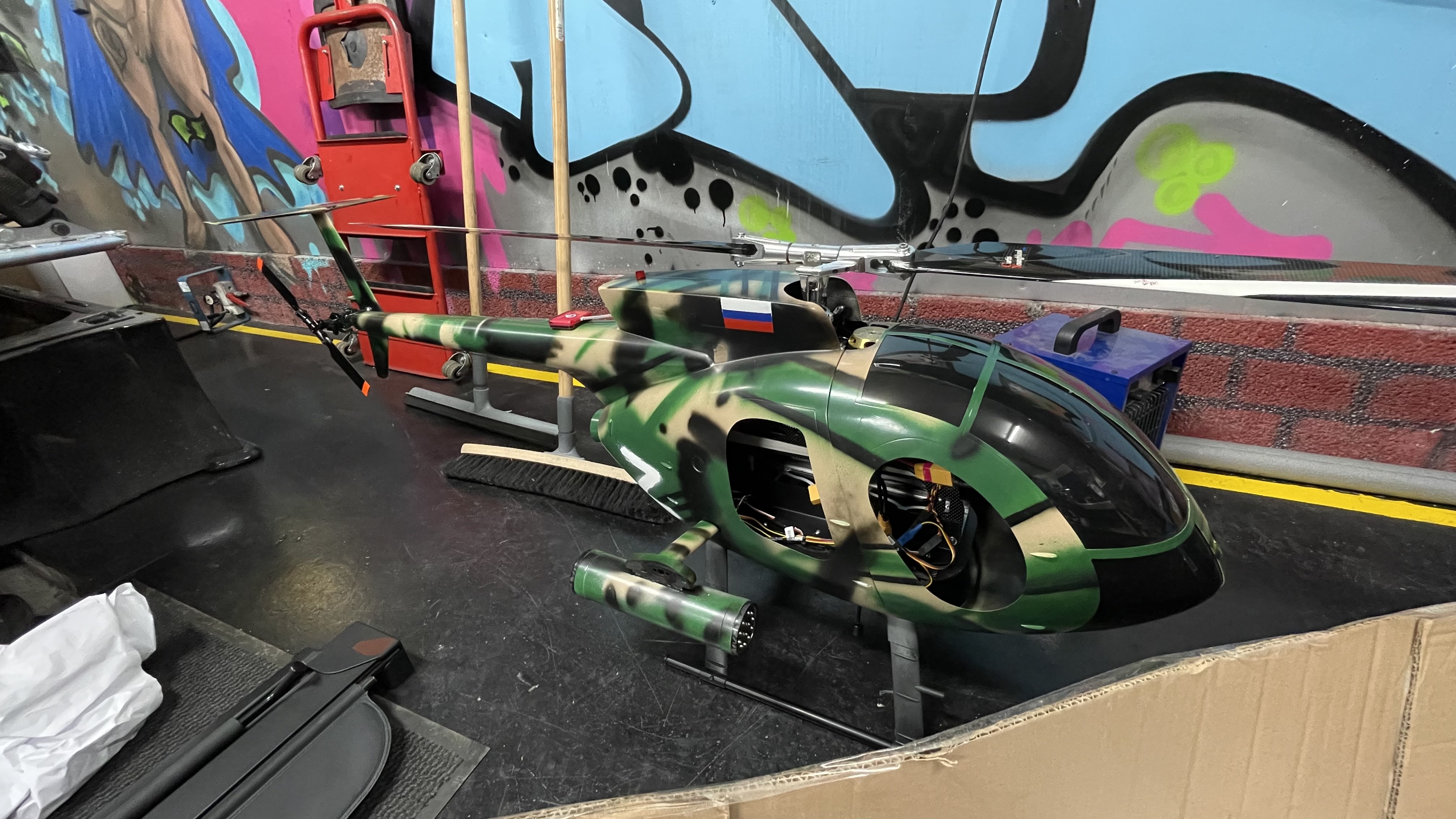

Have you tried without fuselage? I cant see any photo from how the GeoLink is mounted on your helicopter.
Unfortunately almost all pilots (including PRO pilots that are flying at the biggest events) are convinced that their model is perfect. Even 20 different pilots might not find what 1 other can find in 10 seconds. For this reason I always want to check everything even that you think it is waste of time.

Mounting them all the same at the wing. I dint use or have active any altitude/position hold as i found out its drifting to much and very sketchy.
Would vibrations be a issue for geolink in that case? If body move a bit
Rdlx3m
Posts: 65
Joined: Mon 03. Apr 2023 14:46:19
this is my profile... see if you can see anything.
but no, never tried without fuselage.
but this is a new fuselage, and different setup. same reaction
