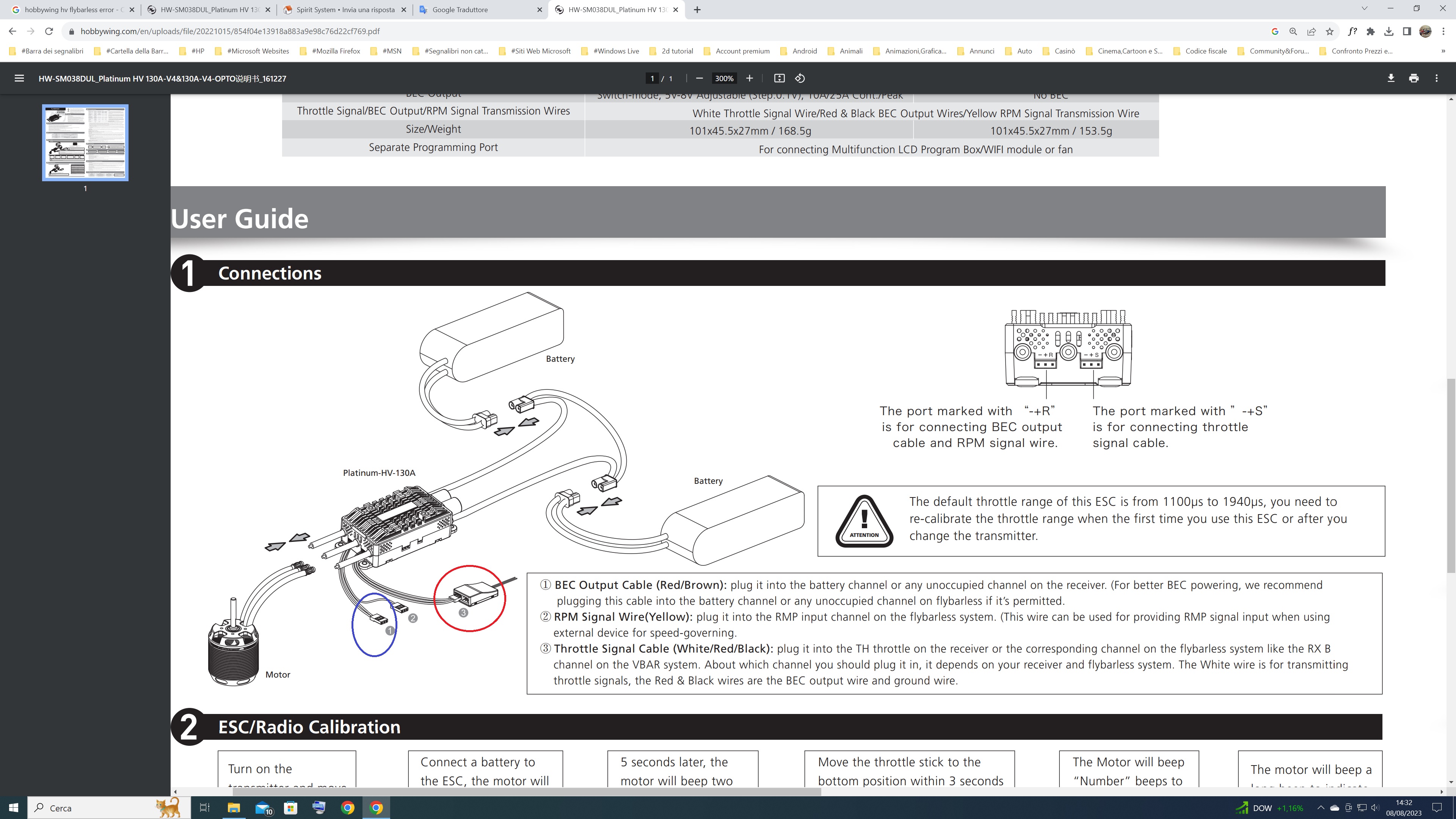

my esc it has two spines
I connected the one circled in red
the plug circled in blue I DIDN'T ENTER IT I can connect two plugs for power supply the spirit?
for now i use port THR the second plug I can enter it in AUX ?
the two spines they have the same voltage (programmable from 5volts to 8 volts)
if I give 7.4v in THR and after in AUX other plug it has 7.4v inserting both of them do i give current for 7.4volts?
I didn't do it because I'm scared 7.4+7.4= 14.8 and that's not good.
can I use two plugs to give current?

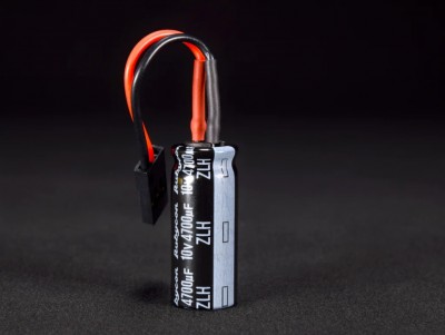

if the error they don't disappear in port E1 can i use a capacitor? comes supplied with hobbywing esc

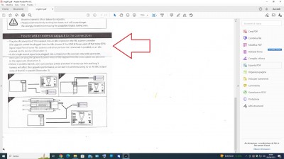

4700uf 10v why the manual says this:
Plug the JR connector of this cappack into an idle channet on the FBL system controller
(the cappack cannot be plugged into the idle channel if the GND & Power wires of the motor RPM Signal Input Pon of some FBL systems and other port are net connected in parallel), or an idle channel on the receiver (illustration 1 ).

Hello Franz,
don't be scared you don'get 14,8 V because this is a parallel connection of the lines, which means that the voltage remains the same - by connecting the two cables in parallel from the ESC, more current can only be transmitted. Each line/connector can only transmit a limited amount of current, but it is then easily possible to supply the nominal current for the BEC from the ESC via two paths - use both cables and the problem will disappear -
Best Regards
Best Regards

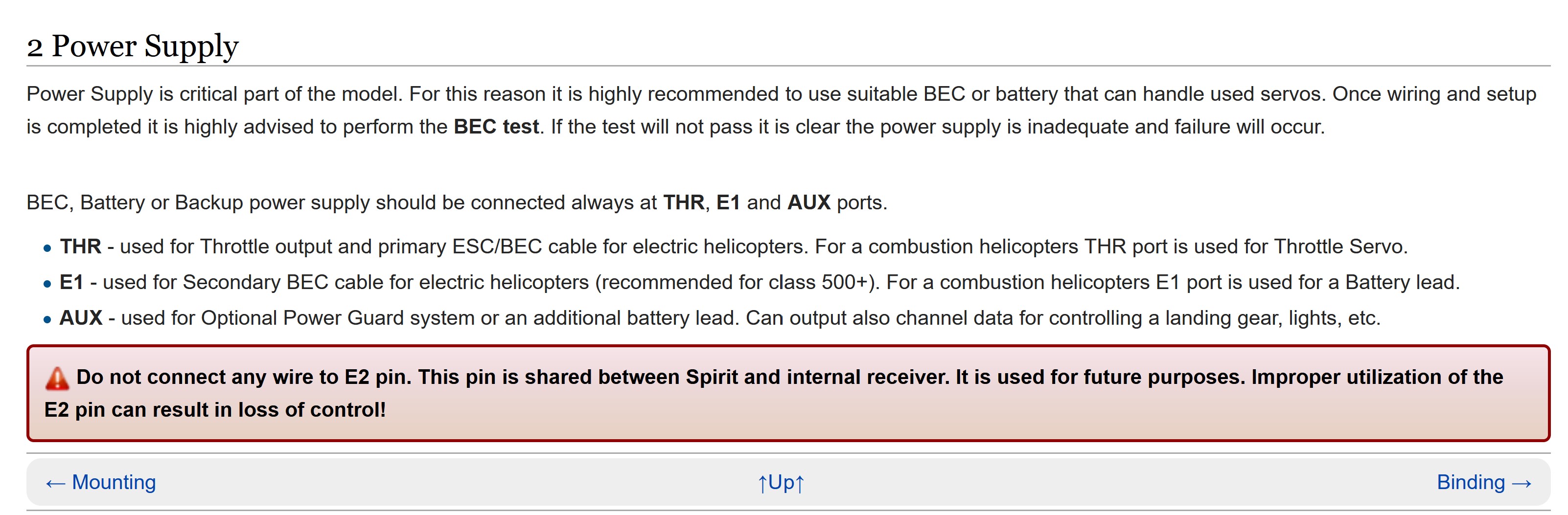

Hello Franz,
look at the spirit RS Wiring in the online-manual...this should not be a problem, you can it put in E1 -
https://manual.spirit-system.com/index. ... tRS_Wiring
Here a screenshot: Best Regards
this is manual capacitor hobbywingMattes61 wrote:Hello Franz,

Hello Franz,
I have already equipped many ESCs and helicopters with capacitors - if you use the capacitor e.g. if you plug it into the FBL side via a Y-cable, there will never be any problems! There is only a restriction on the controller side if the manufacturer says that such capacitors are not permitted, but that is not the case with Hobbywing, YGE and others - this capacitor has no place on the motor side, it would explode immediately! A capacitor, as long as it is not defective, can never cause a short circuit -
Best Regards
Best Regards

Looks that you not read careful what we write here to Help you, I write you yesterday ,that the capacitor you can plug it in every free port of the Spirit Flybarless, or receiver!
franz88 wrote:and the capacitor? I can insert it in a free port (e1)? I would not short circuit the spirit
