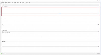

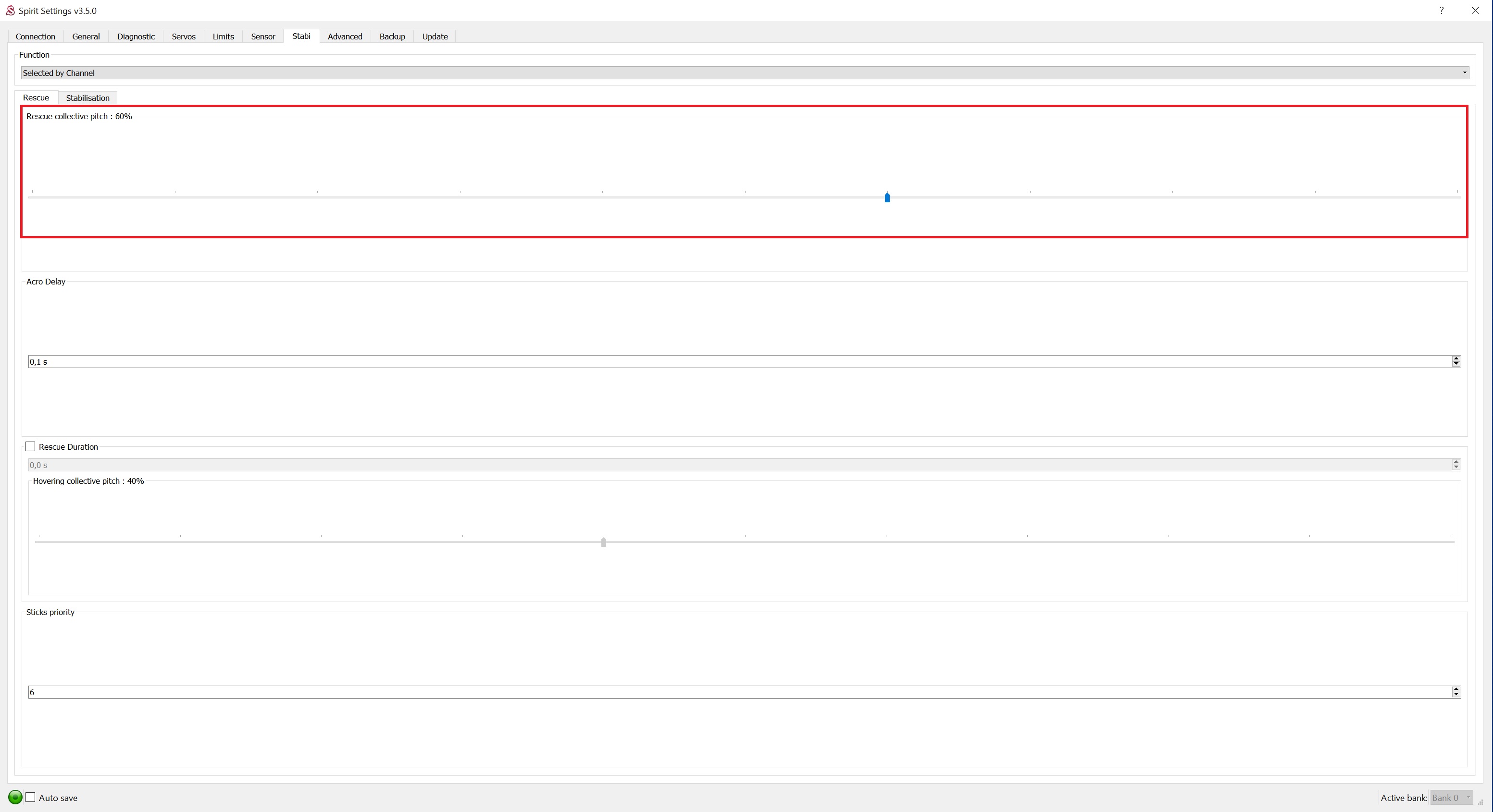

if you in rescue collective pitch change from 60 to any number and when you activate the rescue the plate always goes to 0 degrees not is one problem of settings why from 60% to 90% the swashplate from 0 degrees it had to have a higher number.
but if I'm not mistaken always goes to 0 even if you move this number (rescue collective pitch)
not is normal.

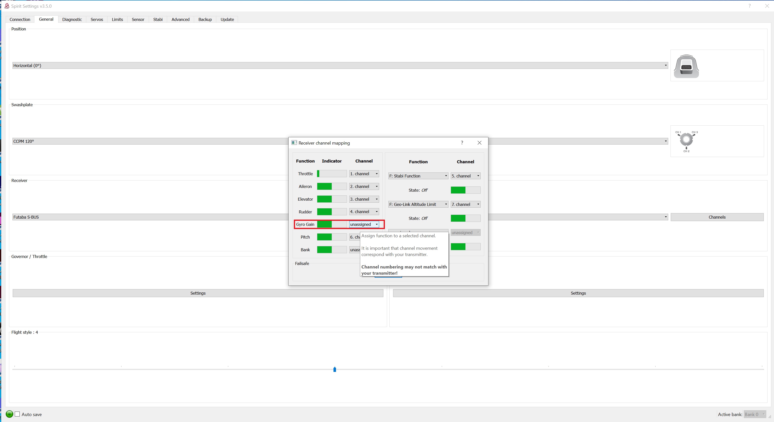

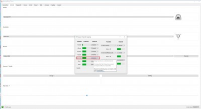

attention but you not have channel gyro gain??
set one channel for gyro gain and if it does not work try to move the gyro gain -50%
you can control the rescue with the gyro gain and maybe there is a problem between channel method and gyro method

I have made two more videos. In the first one I show a 30% flat curve that gives about 3 degrees positive collective pitch. But enabling rescue show pitch going to zero. I didn't understand what you ment by gyro gain but in the the second video I set Rescue to be controlled by gain instead of a channel But the behaviour is the same as before.

and after in channel (spirit software) you don't have a channel assigned
try to assign the gyro channel and try.
