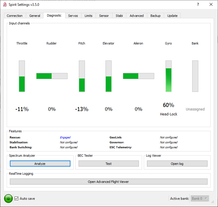

If you are reliably able to trigger Rescue from the radio and the Spirit Configurator shows Rescue with blue lettering "Engaged" but the collective always goes to zero degree pitch you may be affected of this error.
To verify you can try to change Rescue collective pitch with the configurator or with an rc channel and the variable P:Rescue Collective Pitch with for instance a potmeter on your radio. If changing Rescue Collective Pitch does not change collective pitch during rescue but it stays locked at zero then you may have the same issue as I experienced.

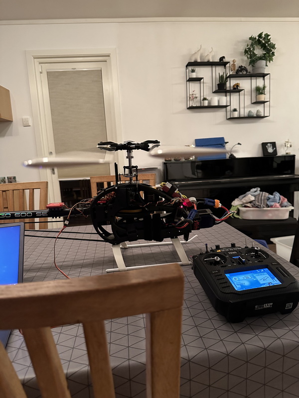

Hi, I have a problem with my Spirit GT mounted in a Logo 600. The heli flies fine but Rescue does not work as expected. On the bench when Rescue is triggered the collective goes to zero degrees pitch. This happens if colletive is positive or negative when rescue is triggered. The same happens when the model is held inverted. Adjusting Rescue collective pitch makes no difference. In the air the heli makes no attempt to change orientation but decends at a good pace that would suggest collective pitch is at zero. Collective is locked when Rescue is activated but aileron and elevator can be controlled (as expected).

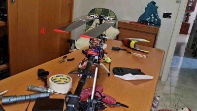

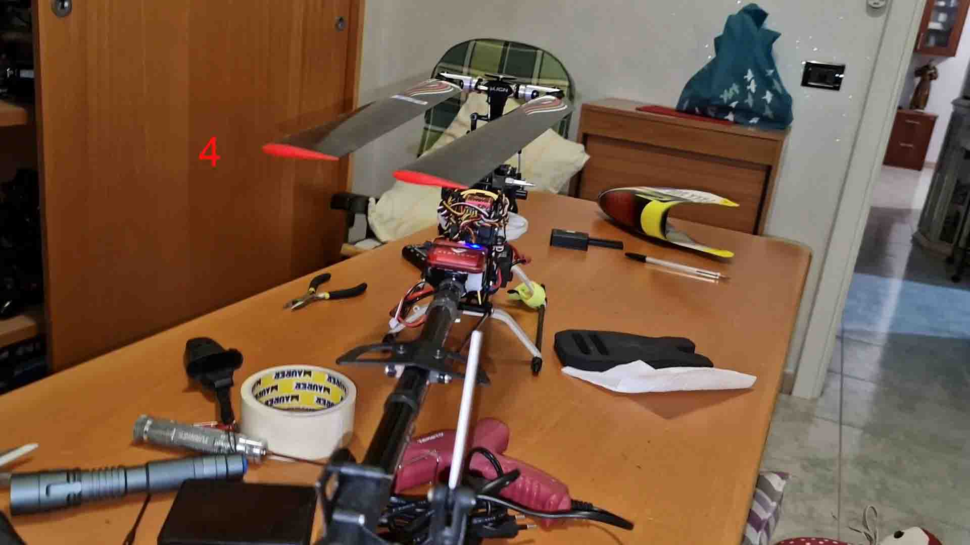

first go in servo- subtrim (tuning) and put the blade as in the photo and spin the rotor 360 degrees
the two blade they always have to touch they must not have unlevel different at 360° in all position

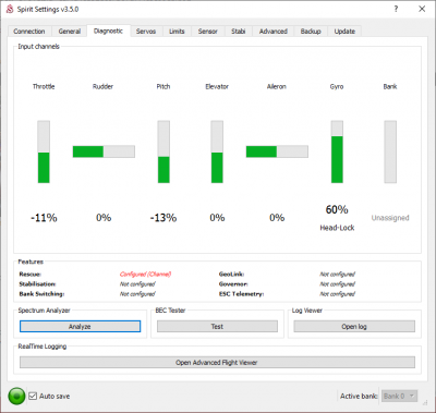

finally diagnostic - rescue the red writing
configured: channel when it is deactivated and written blue when active (is automatic)

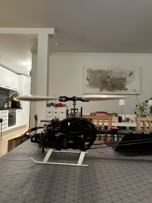

I have check subtrim in all orientations and it is spot on, no discernable difference in the height of the blades in any orientation.

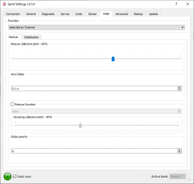

Rescue is also set up correctly, pictures below.

Copied and pasted from the Spirit Manual...
Rescue Duration:
Once specified duration period will pass the Rescue mode will end and model will start to hover. For this purpose Hovering Collective Pitch value is used. The period is counted from time the Rescue mode was engaged. The parameter is available for both Rescue (Normal) and Rescue (Acro). Transition from Rescue to Hovering is smooth and will happen only if Rescue mode is still engaged. Collective Pitch control is returned to the pilot as soon as a pitch stick movement is recognized.
I would suspect it is as simple as ticking the box for Rescue Duration. Maybe set it to 5 sec for the bench test. In real life that might be too long tho. I use 1.5sec but its personal preference. From there adjust your hovering pitch to whatever your model hovers at out of ground effect. If unsure Suggest starting around +60%.
Also change the acro delay to 0.3 sec. 0.1 is too fast IMO
As a side note, your cyclic ring tuning should not be more that your collective pitch. You said you have the collective pitch set to +/- 10°. So you cyclic pitch should be no more or a little less than 10°, without any binding of the servos of course.

I've tried activating Rescue Duration and increasing hovering pitch but it makes no difference. Also the manual is very specific that rescue is active as long as the switch is kept engaged. Rescue duration seems mostly to be a method to disengage rescue automatically if one is not using a spring loaded switch.

I've set the heli up with a swash gauge and it's very close if not perfect. Servo horns are as dead center at I can get eyeballing it. I had a little less thanone degree more positive than negative pitch which I corrected in the Servo Travel Correction settings.

Excellent video, however I don't see any mistakes I've made. All travel directions are correct, orientation of the Spirit is correct etc.
The earlier pitctures were taken with subtrim tuning enabled. There's maybe about a degree difference around the circumference of the rotor disc measured by a digital pitch gauge. But even if there is a very small difference here, how can the Spirit be aware of that on the ground?
