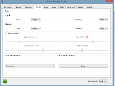

Dropped unit at Esprit on Tuesday and James checked it out, he found no issues but re-flashed it. I am going through the setup again, starting at beginning of manual and working my way through. Having another problem now. I set the subtrim to level out the swashplate, save the settings and turn off unit to make sure it boots up the same. Not happening. Every time I restart the unit, servos are no longer level. This is no longer any fun as they do the same thing no matter how many times I level it out.
I am using the unit with DSM2 satellite receivers connected as per manual and when I cycle the unit after setting subtrim, I do not touch the transmitter so nothing is moving via that. I have spent many years working with telecommunications equipment and computers and I have found that there is always the possibility of a glitch regardless of stability of equipment, it is just the nature of the beast. Not saying that is the case here, but I know it could be issue. Also spent many years working on air conditioners and cannot tell you how many times manufacturer would tell us they never had our particular issue before.
I did not actually describe the first issue properly. It was not that the settings changed, but rather the operational direction of the piro optimization reversed. Not liking this at all since I am now having to spend more money before I can even get the thing setup properly.

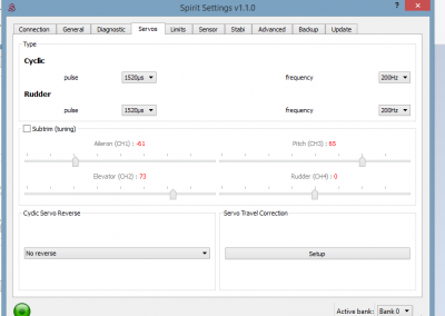

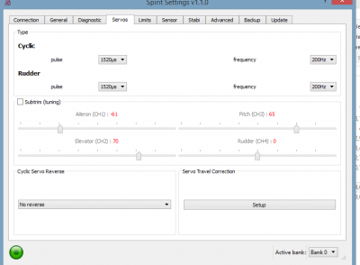

I have a swashplate leveler on main shaft. Using subtrim, level swashplate. Save settings and get the "settings saved" message. Turn off power to unit, wait a few seconds and power up. Unit starts up and the swashplate is no longer in same position as it was when adjusted using subtrim and saving settings. Not paying attention to blue or green, but just checked and yes, it turns green after save confirmation box.
I am attaching 3 screen capture files to illustrate what I am having issue with. Note the changing values of sliders.

miroker wrote:I have a swashplate leveler on main shaft. Using subtrim, level swashplate.
Hi, miroker to clarify:
Do you mean that all 3 pictures show the moment the swash is level? Yes/No?
And between each picture you restarted the FBL? Yes/No?
Did you restart the software beween each of the 3 pictures? Yes/No?

miroker wrote:I have a swashplate leveler on main shaft. Using subtrim, level swashplate. Save settings and get the "settings saved" message. Turn off power to unit, wait a few seconds and power up. Unit starts up and the swashplate is no longer in same position as it was when adjusted using subtrim and saving settings. Not paying attention to blue or green, but just checked and yes, it turns green after save confirmation box.
What heli is this you're working with? Some helis naturally sit at an angle (like my goblin 570) so after the swash has been leveled relative to the main shaft (in servo centering menu), a reboot will level the swash relative to space.
