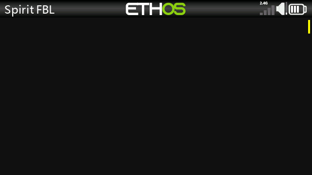

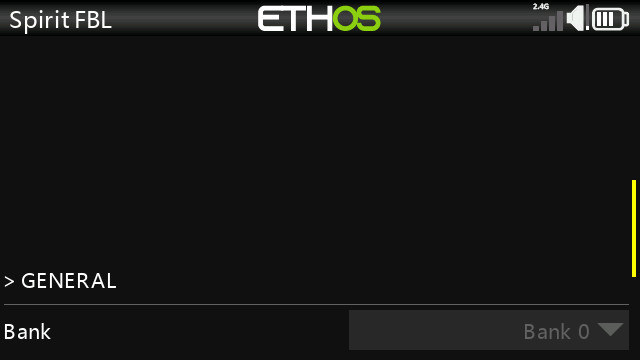

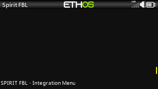

I like the integration to EthOS very much. It is working fine with my 4 Spirit GT units and the Archer RS receivers via FPort on my Tandem X18SE and X14S.
Unfortunately after the 1.5.X EthOS update (I'm on 1.5.6 right now), the screens in the Spirit LUA are getting longer and longer when you dive into a submenu, go back to main and dive into another one. It is only a graphics issue but a little bit confusing at all.
I hope you can see what I mean, when you take a look at the yellow scrollbar at the right.
3
3
2
2
1
1
Posts: 13045
Thank you for your report.
We will test and check what could be wrong. Please report it to FrSky as well, because if their firmware bircked it, they are able also to fix it.
We will contact them directly too in that matter.
