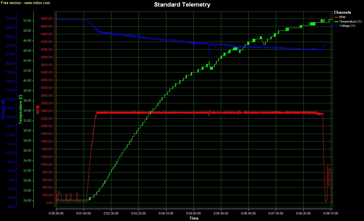

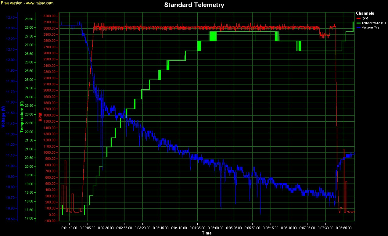

Don't own a Nitro but the governor on both my 450L and Goblin 500 Sport work perfectly (see telemetry below)
Flight style was sport with flips with extra bad collective management and a few rolls. The 450L is struggling a bit more being a 3S as you can see from the voltage drops when punching the collective, but even then the RPM's don't vary much. Also the goblin having much more power can hold much better.

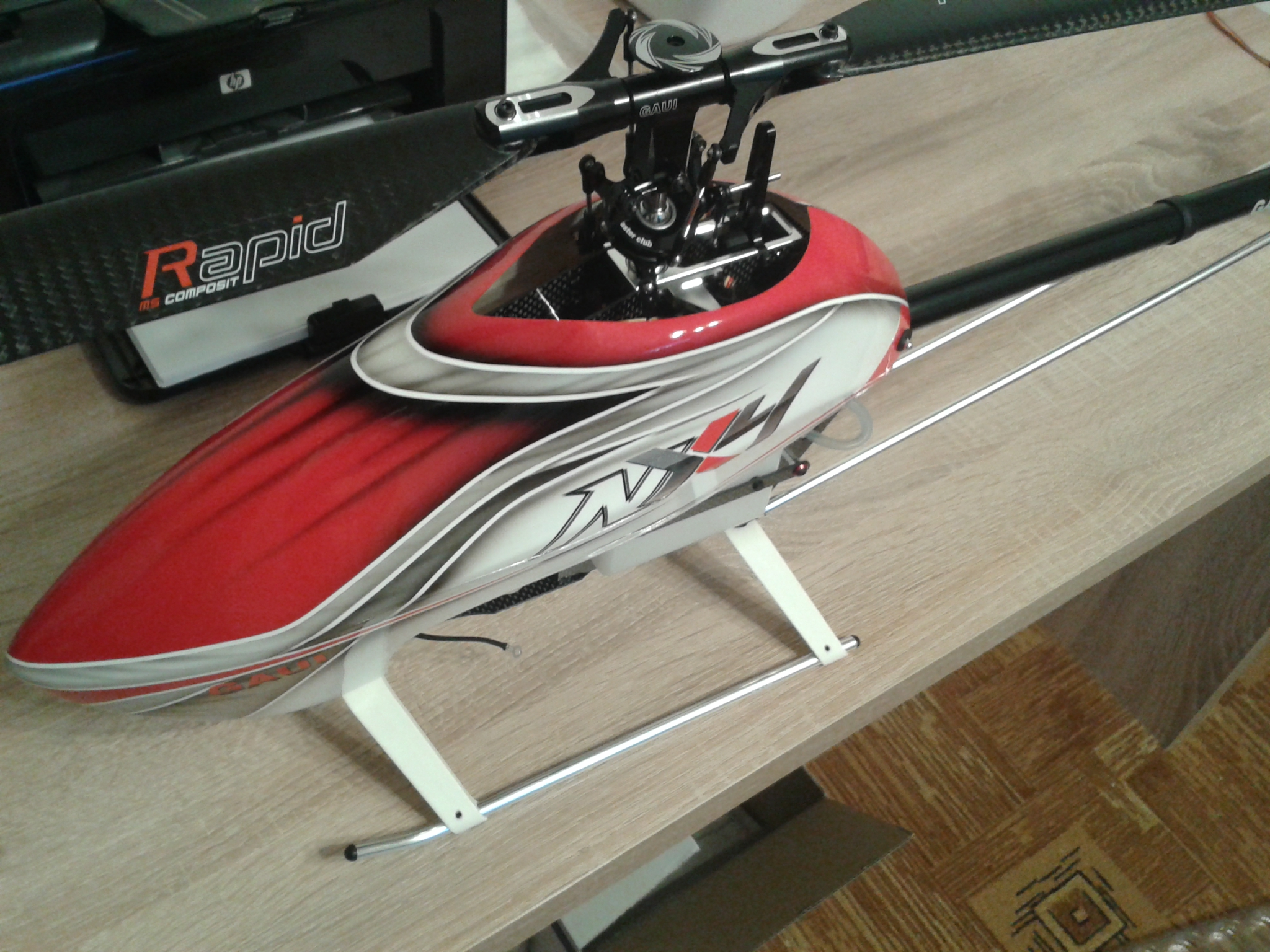

Posts: 12921
Our GAUI NX4 should be ready for testing in 10 days.

Posts: 12921
Nearly ready for testing..

Posts: 12921
We have already found what might cause a problems in this helicopter.
a) Plastic cover for the fan is manufactured so, that it completely covers the magnets, making connection between sensor possibly not strong enough. But there is one hole for this purpose - altough not everyone is using this, because it may not be in a good position for your sensor.
b) Manual suggest magnets polarity - one positive, one negative. I highly recommend two positive magnets or just one (we will find optimal count).
