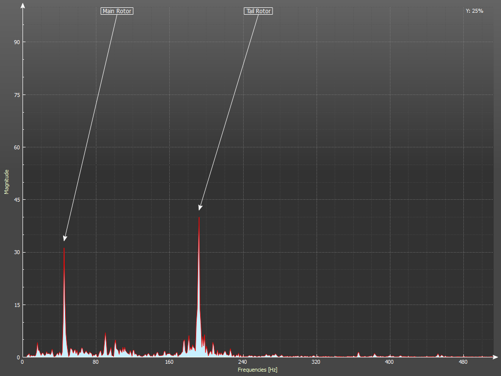

What I recommend is to measure vibrations in the (especially) Y axis with Spectrum Analysis in the software and tail blades on.
This could tell us precisely if it is good. Mounting point is place which has also a lot of vibrations because bearing on this model is very close the unit and often it is not changed/checked frequently as it is uneasy.

Ok, I have checked the Y-Vibrations and found some. Not that bad but there were some. But it's strange that the indicator of the telemetry data during flight only showed minor vibrations. So to make sure that this isn't the cause (or solve the problem when it is the cause) I have ordered some spare parts to get rid of the vibrations.

As mentioned I have replaced several parts depending to the tail. The Heli flies now as quiet and stable as never bevore. The vibration level in the analysis is still not perfect but at a very low level (see att with no main head but blades on the tail). During flight I get a vibration level of 11 in the mittle with minor peaks up to 30. Therefore I think that shouldn't be the problem any more.
