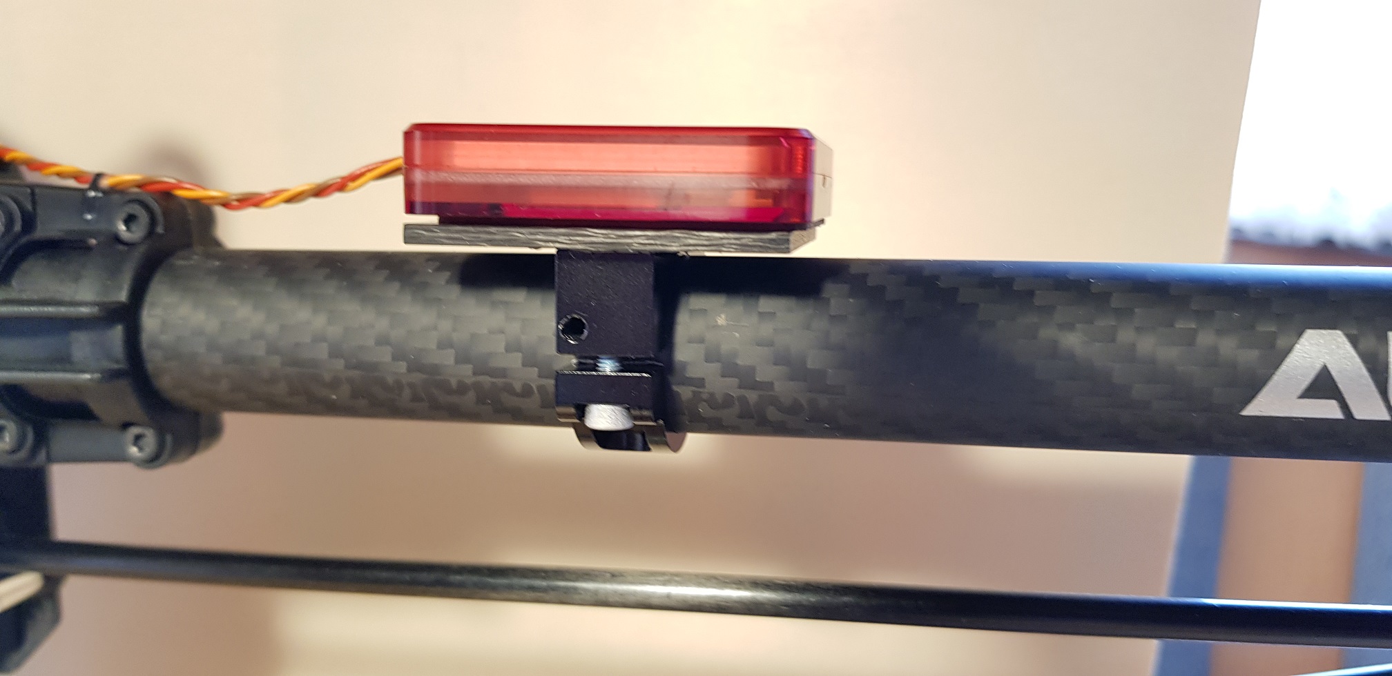

1. Please clarify the Geolink mounting method blocking the free air circulation issue. He mount the Geolink on a flat surface and the bracket seems to cover the whole bottom surface of the Geolink module:
Is this the problem? Is it necessary to have some portion of the bottom area expose to the free air as below picture:

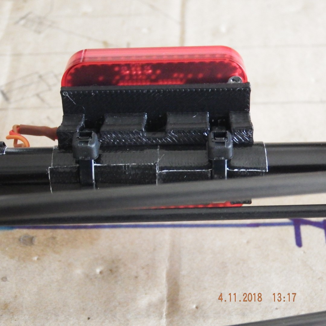

I am asking these questions because on my new Geolink mount design, the bottom of the module is completely covered when assembled. Only the four sides and top of the module is expose to the air. Is that good enough?

1. This mounting solution seems to be OK except we highly recommend to use no metals or conductive parts around. Booms are not a problem, they are thin and further than GeoLink holder. But a smaller area the holder has is always better. If there is no space between holder and GeoLink than it can help too. At the photo there is unnecessary area which does not help. Rest has double sided tape.
2. The new holder is just fine.
I will send you a private message regarding the firmware.
