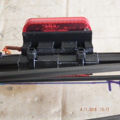

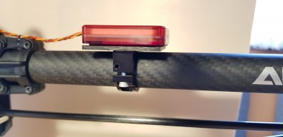

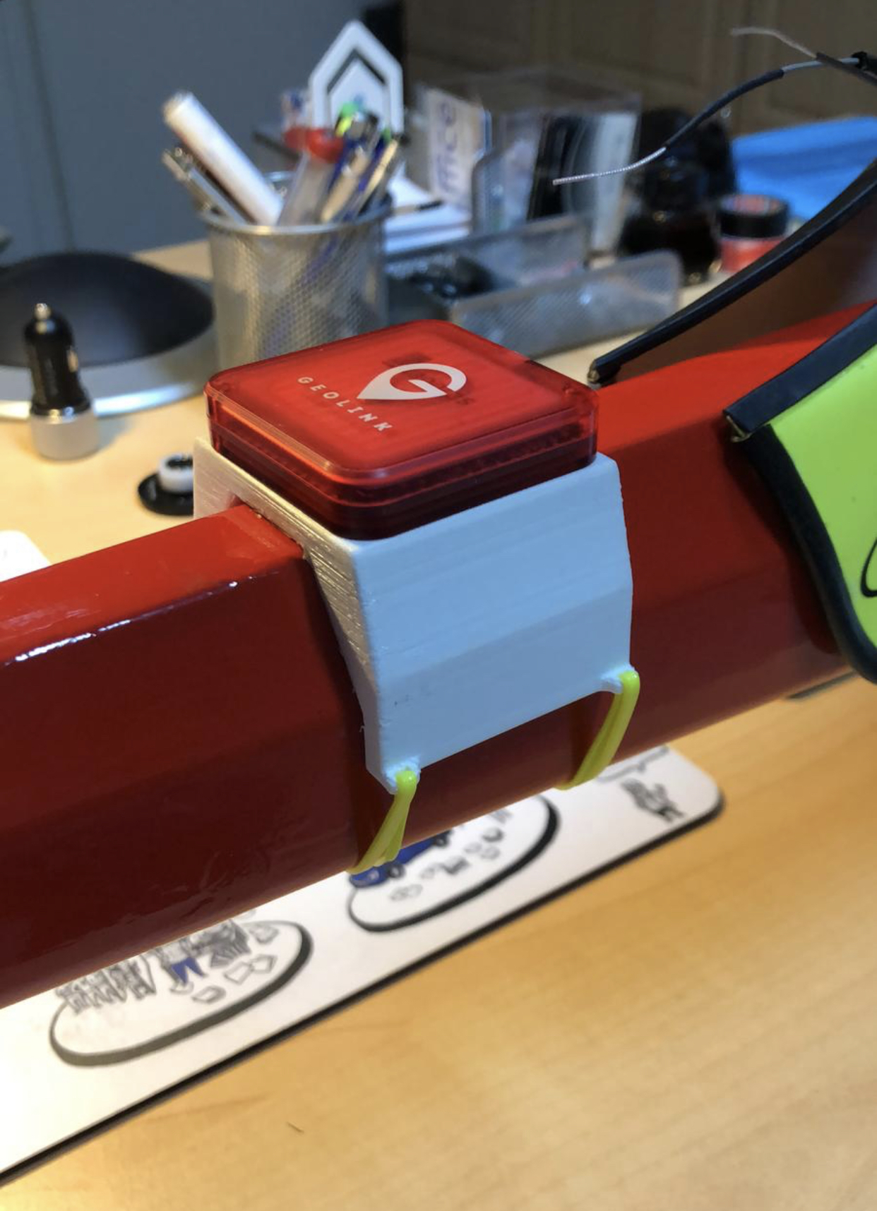

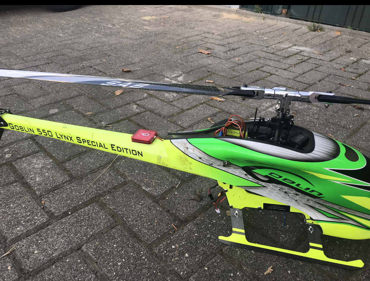

Hello Erik,
thanks for the details. Could you take a photo of how GeoLink is mounted at the model, please? This is the main factor that has influence on the pressure sensor.
eg183100
Posts: 29
Joined: Tue 09. Oct 2018 12:31:17
Here is a picture
eg183100
Posts: 29
And a picture of the mounting on the Second heli
