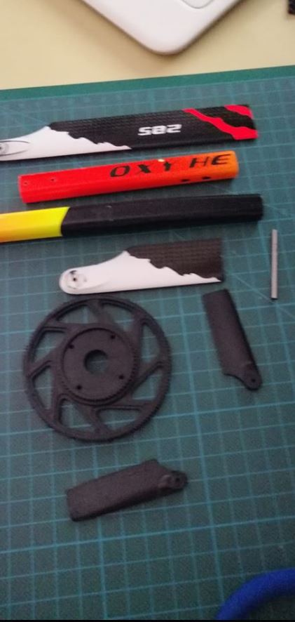

This is what the text gen on my Spektrum Ix12 has done to me
By mistake I changed the installation direction of installation heli inverted from 0° to 180°(orientation) in the Spirit from the Text Gen Menu, and in hovering 20 cm from the ground, my Heli big and violent crash!!!. 100 euros of damage.
The text gen works very badly because to enter and exit the integration on the ix12, there is the same stick movement (I think it's a bug to update). Not only if you change a setting in Text gen save it immediately, even without exiting and then saving
