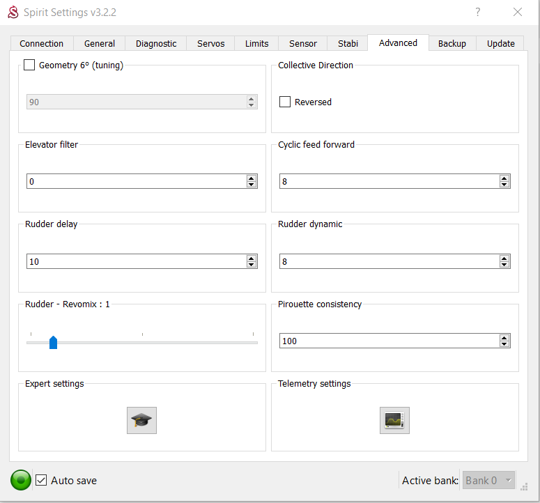

yes, we were testing M2 some days ago and it is working just very well.
There is nothing special you have to do, except Head Geometry is really very unusual. So to compensate this we obtained the best results with Head Geometry 6° around 90.
Other possibility is to use Travel Adjust to correct it. Then you can leave a proper Geometry value, but easier is to lower the value.
RPM output including Governor is working flawlessly.
Settings in the attachment.
