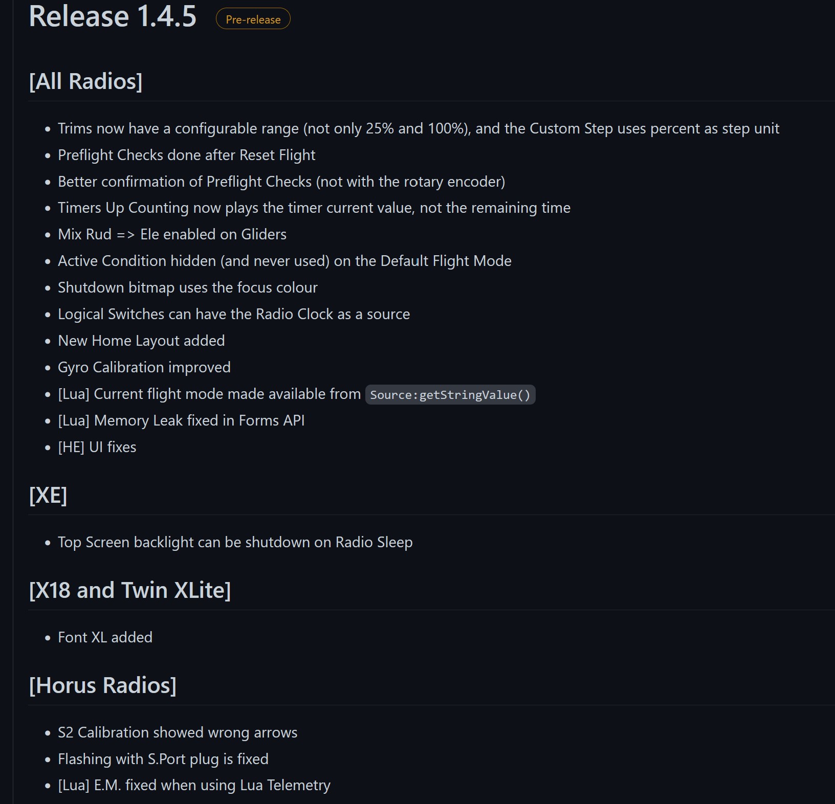

Posts: 12887
we are still waiting for reply from FrSky.
There is chance the errors will be fixed in 1.4.5. 1.4.4 is still the old one where the errors on X18 are present.
But with RTN button they can be at least bypassed.
In the LUA scripts there is actually everything identical for all receivers and all radios.
The actual issue is, that even that it should behave identically on all devices, it is not. And there is no reason why, except there are bugs in the EthOS that must be addressed. There we have no way how to fix it.
