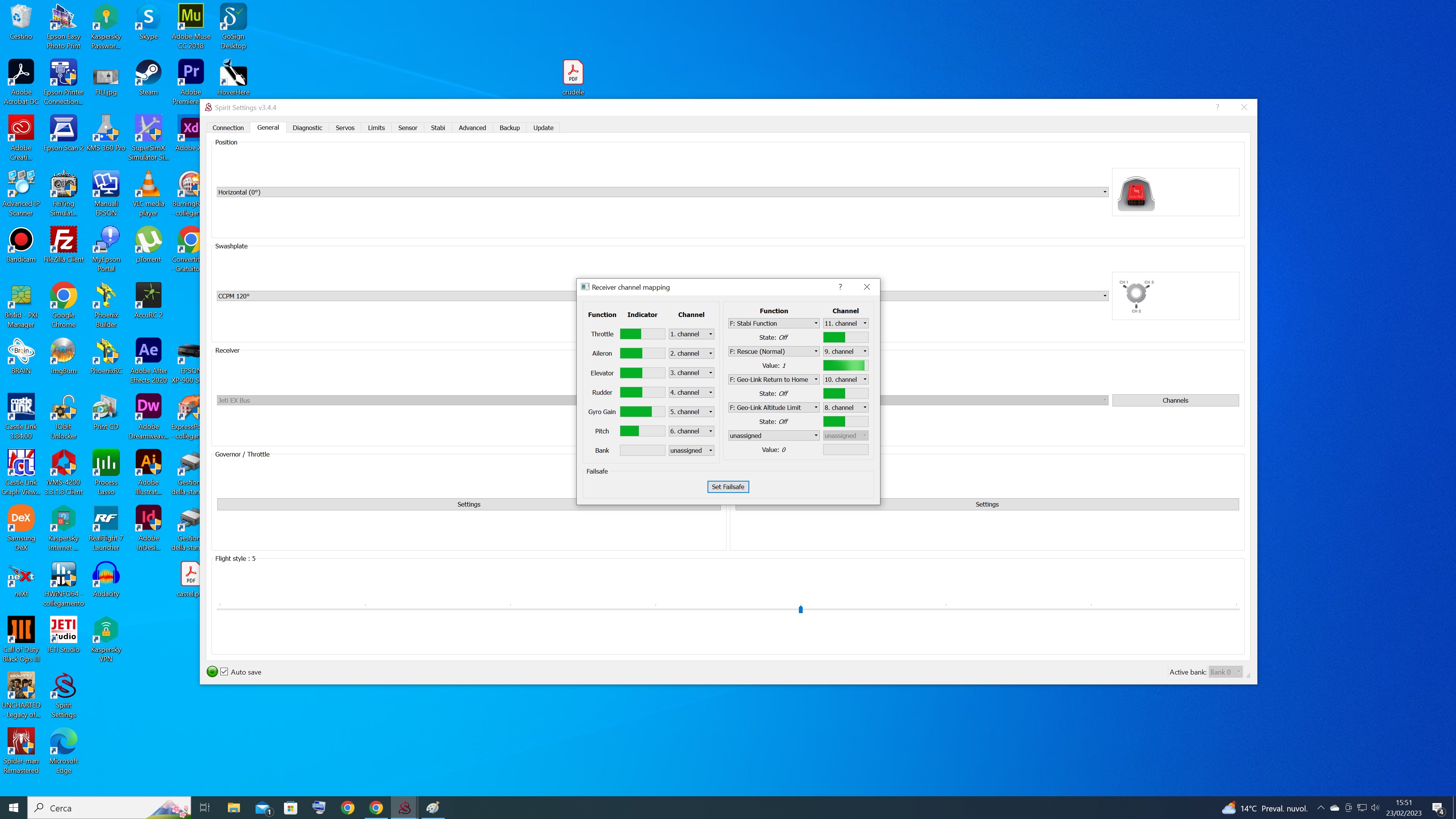

Posts: 13045
I think I found the problem.
Please reconfigure Stabi/Function to Selected by Channel.
Then set: General/Channels - F: Stabi function to F: Rescue (Normal).
From this moment all should be OK.
Regarding tail it seems that Governor Reponse is quite low. This could cause the problem.
Governor has direct impact on tail. If RPM is holding poorly or too strong then in both cases tail will not operate well.

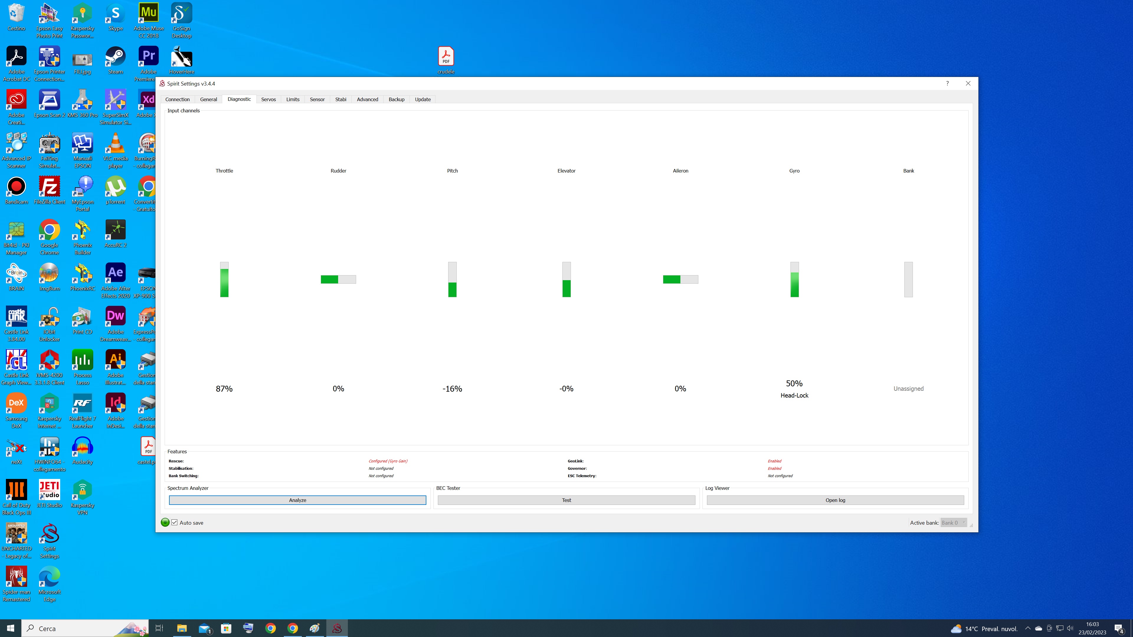

if i selected stabi-selected by channel
in channel- f:rescue normal if i move button switch is ok 0 for off and 1 for on in this screen is on why i push button and is ok
but in diagnostic- feature remain configured gyrogain but if i active the writing turns blue and if i move gyro gain in negative it doesn't turn blue then it remains deactivated it's actually ok but the writing stays like this
why?
there is no way to exit selected by channel, it only exits if stabi function is used.
but the rescue seems to work fine is only written selected by giro gain it's wrong
Posts: 13045
the problem is that you have F: Stabi Function.
It must be removed from the Channels assignment.
It can't work in that way and can affect all GeoLink functions.
If you use Selected by Channel then you have to set directly functions that you want to activate in the Channels window - F: Rescue (Normal), F: Stabilisation...
Unfortunately I do not understand the problem from your description, but I am certain that you have to remove F: Stabi function. Then it should work correctly.

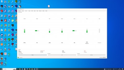

I'll post pictures for you to understand better.

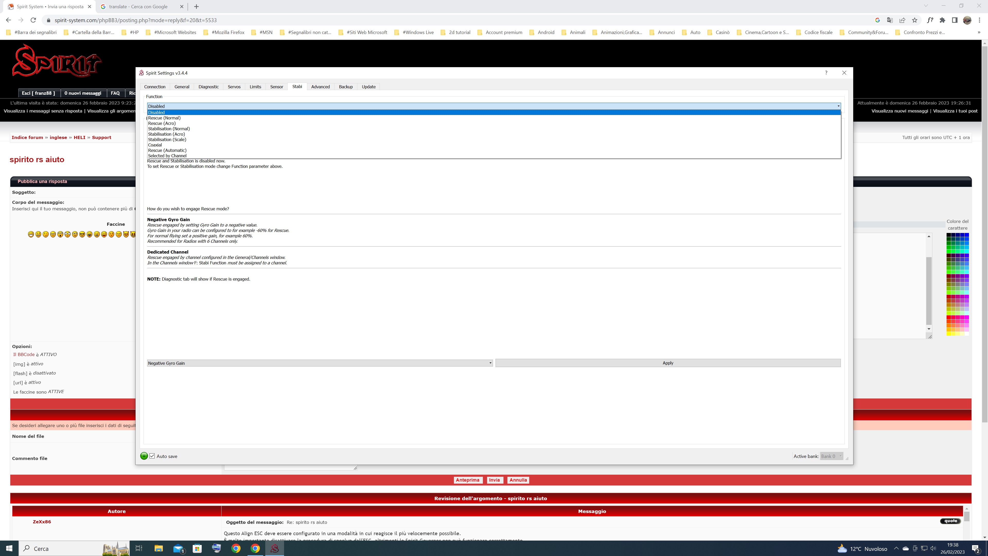

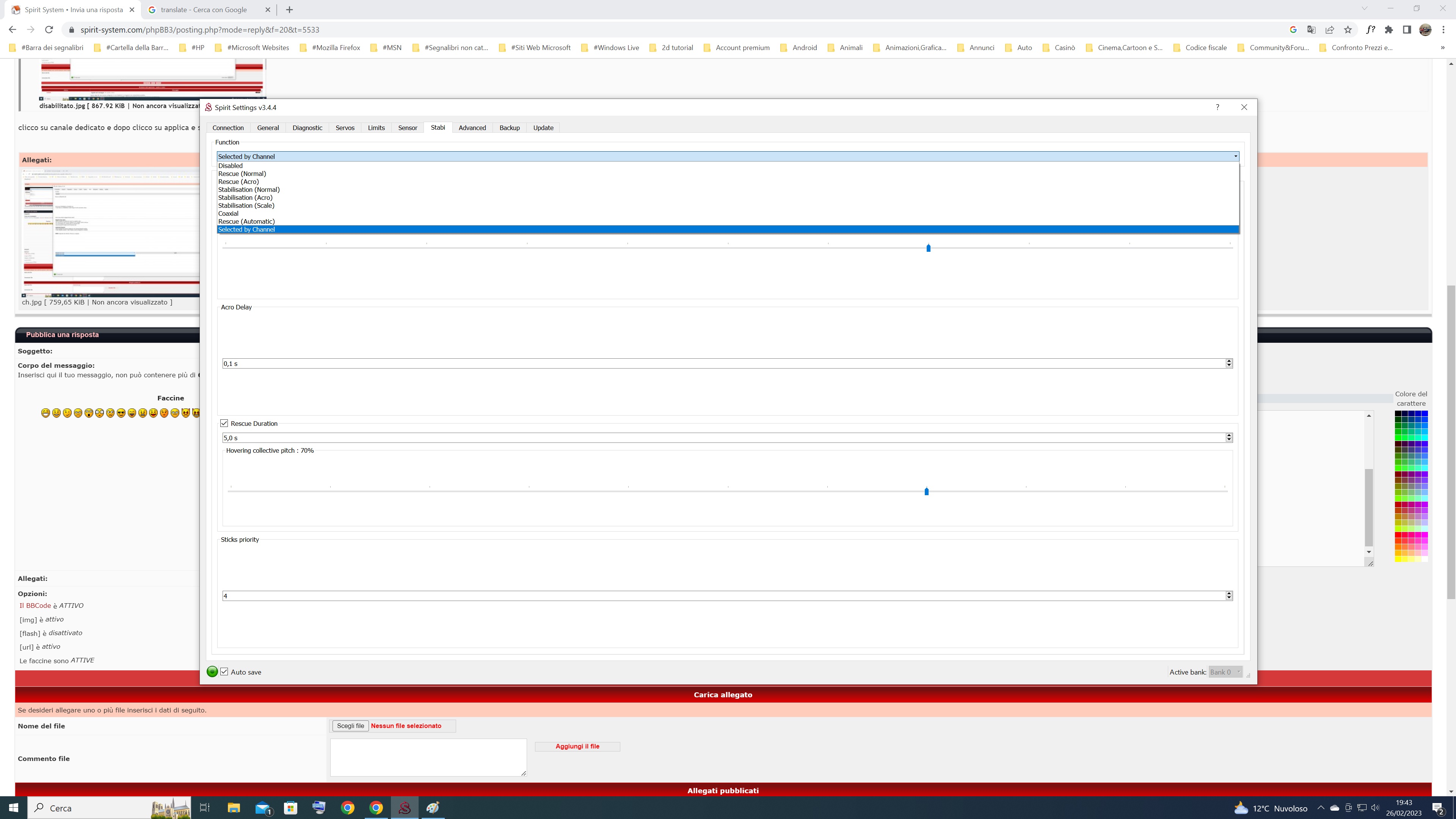

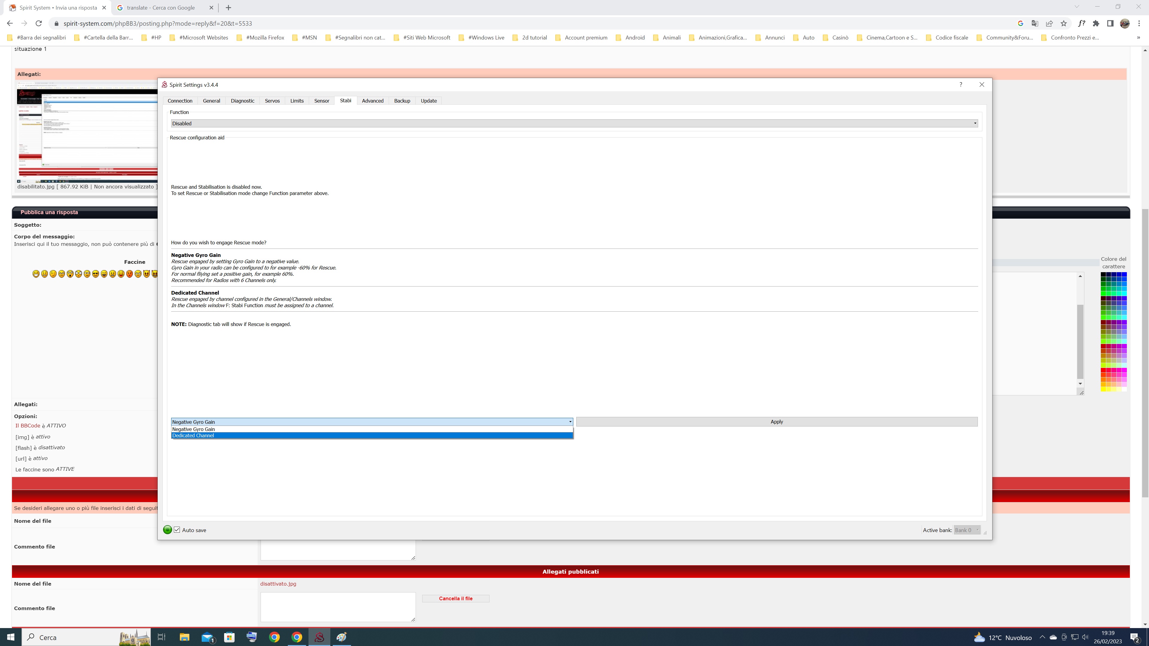

situation 1 i click disabled
i click dedicat channel and after i click apply and spirit in automatic create in channel f stabi mode
after i put in stabi - in function - rescue automatic

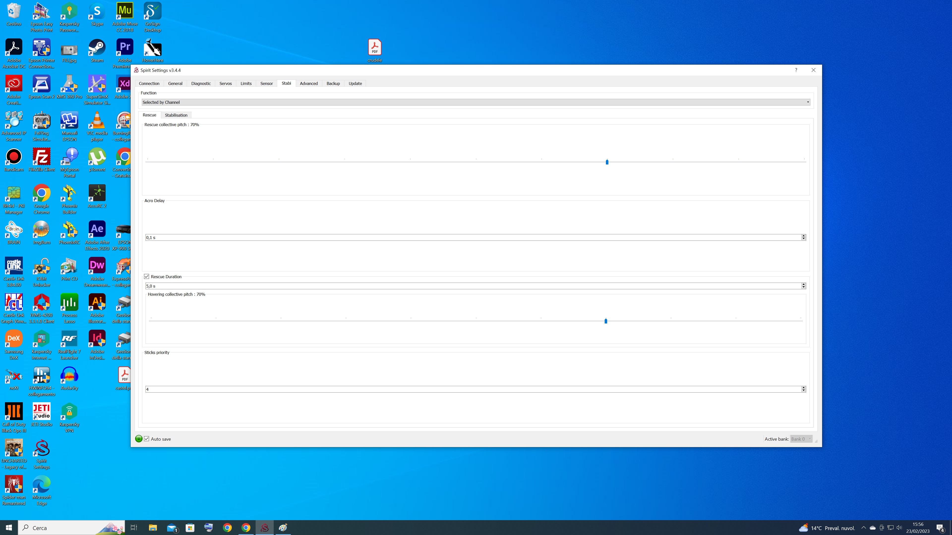

situation 2
i click in stabi selected channel but in this mode I am forced to use the rescue normal with stabilisation
or i wrong method or after some software update f: rescue automatic It does not work anymore, the problem there is also in the spirit gt are you sure now works? Maybe it worked fine in older versions but now no.
