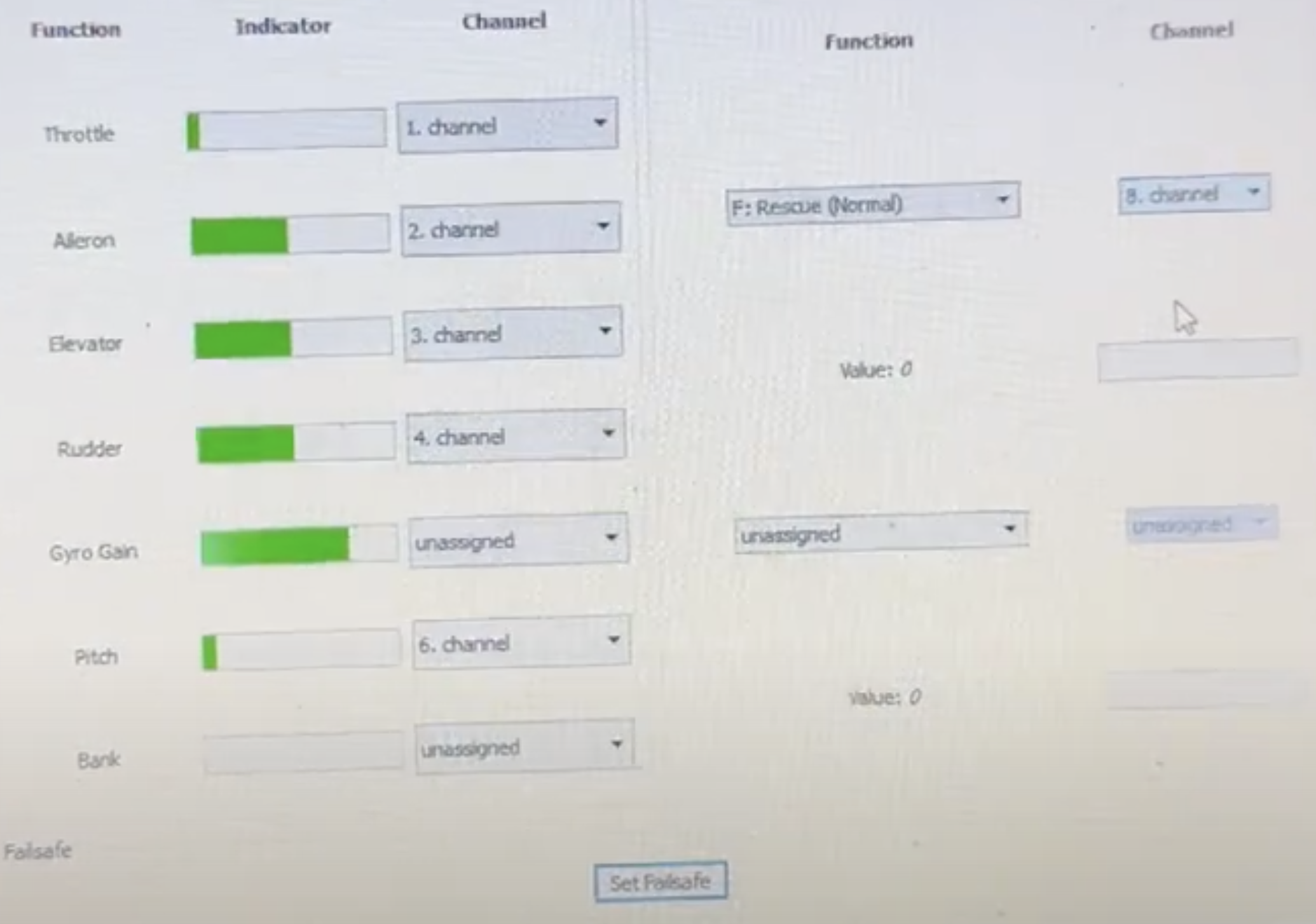

Posts: 13045
After checing your settings file I found the mistake immediately.
You have not set F: Rescue (...). Instead you set F: Stabi Mode which is mistake.
Then it will work immediately. I recommended to check it at the beginning. However it seems the mistake is still there.
You are mixing two engaging modes together. For this reason it cant work.

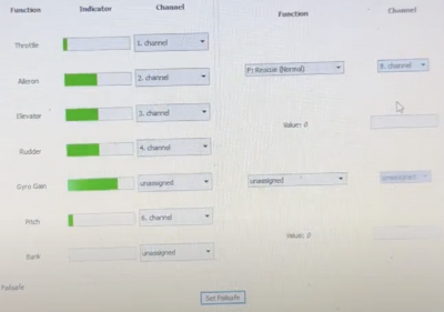

HeliMLM
Posts: 370
ZeXx86 wrote:...You have not set F: Rescue (...). Instead you set F: Stabi Mode which is mistake.....
Hello Tomas, this is already corrected by the user "loctite" after we exchanged on his settings on HF. see attached a screenshot of the last video he posted some post back >> where this setting is ok. ("F: Rescue" & "selected by channel"). anyhow not working.
