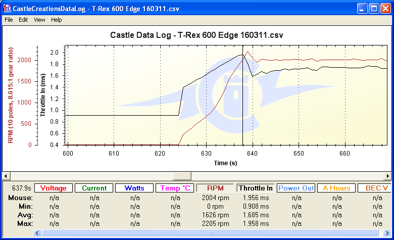

In the last two days I have tested the autorotation bailout - it works perfectly. But one thing I have observed - on the first spoolup the RPM overshoots by 100 to 200. It's not a critical issue, but can it be fixed ?
Here is a screenshot of the governor settings.
Yogi43
Posts: 88
Joined: Sun 28. Dec 2014 22:39:47
Here a screenshot of the spoolup in the log of the CC. The red line is the RPM and the black line is the throttle.
Indicated by the marker, the throttle is reduced upon reaching the requested head speed of 2000 RPM. But then the headspeed goes up to 2200.
Is this caused by the ESC or is it possible to flatten the spoolup from the spirit in the last 10 %. In the shown case the throttle is increased up to the configured maximum of 1950us.

Is it possible, that only my initial spoolup rate in the CC is too low? I will try.
