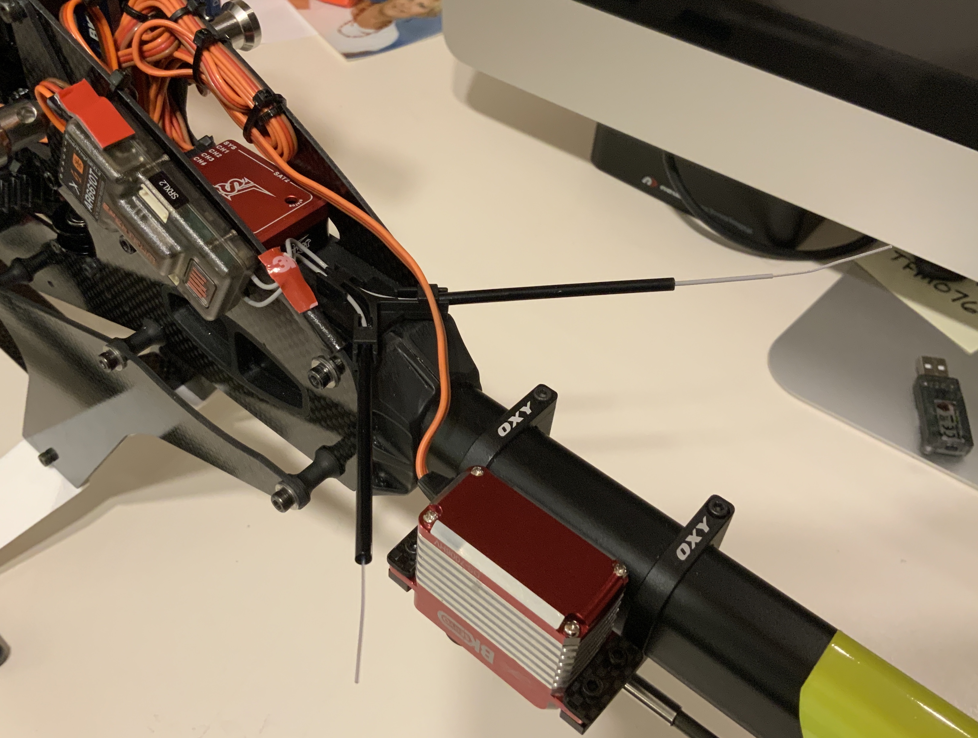

It also have a flightlog where you can see lost frames,holds,fades,rssi.I tested it the heli in the house,i went out
closed the door and have to go about 10M from the house Before the rssi drops to 75%.
And whidh rangetest aktivated the rsssi still show 10% outside the door.
I think there is no need for a additional remot.Mount the antennas so that one can be seen no matter howe the
heli is orientated.[img]
