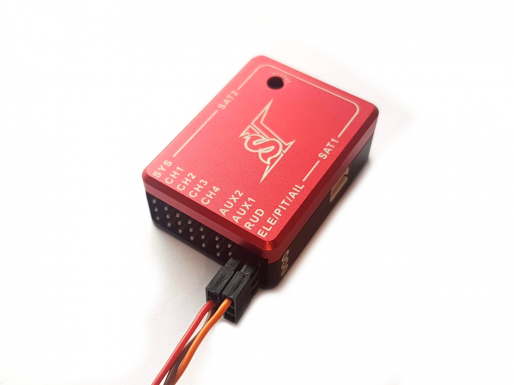

Hi serius problems
I have install the new AR6610T in my Kraken(Spirit pro)using the Jeti cable.And the unit dont show any respons at all on stick input.I have folow the manual and set the unit rx to srxl2 plug in yellow Cable in ail pin +- in rud portit is the same as SPM4649T,the other end in rx markt bind/prog/srxl2 yellow Cable in the pin markt whit an
S.I Think Every cable is connected right.i have tested the rx by plug in servos in different ports it works fine.
i have install airware 2.05 in tx 2.8.0 in spirit.The led on unit is solid the log says good helth.
IN diagnostic page all channels show 0 or 50%.
PLeas help?
//Lars

It looks like you have something in the sat port. What cable is that? If it’s a regular sat you can’t use it. If it’s a srxl2 sat then it should be plugged into the AR6610T.
From the receiver port
Orange should go to Ail pin
Red + should go to + on rud port
Brown - should go to - on rud port
This the same for the Spirit Pro

In The satport is esc telemetry connected,The red cable going to pitch pin is The rpm from esc.
I have no sat connected nor unit or ar6610t.
And The orange cable from rx going to ail pin on unit and +- from rud port on unit to rx.
I used The spm4649t and one sat before,it works perfekt. I guess i have to go back to that combo
//Lars
