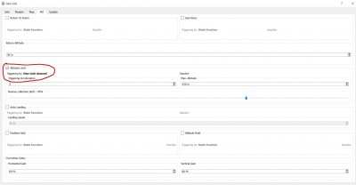

Spirit rs with geolink i just tried only limit altitude.
I tried on1 and on2.
maybe I don't understand because of english.
So I ask simple questions.

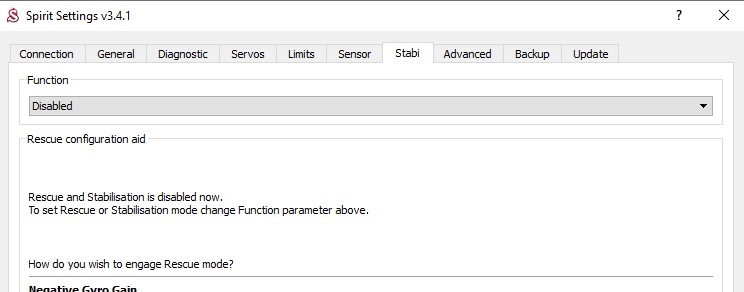

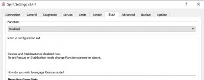

In this test the board Stabi - Function is set Disabled (I'm trying them all)
If i active on1 the model it goes very high and NOT IS NORMAL the helicopter must go up only for 1,5second.
10 meters 20 meters and after I disable it to stop it, because it is too high.
Now if i active limit altitude with on2 i set channel at the minimum possible -9% (below goes off).
In this mode the model gets up of 15meters and after stops and you are control again.
In this mode works well the only problem is that the model goes up 15 meters.
If I return at the altitude where I activated on2 repeats itself, the model goes up 15 meters and then I'm in control.
on2 works well, but it just goes too high the model.

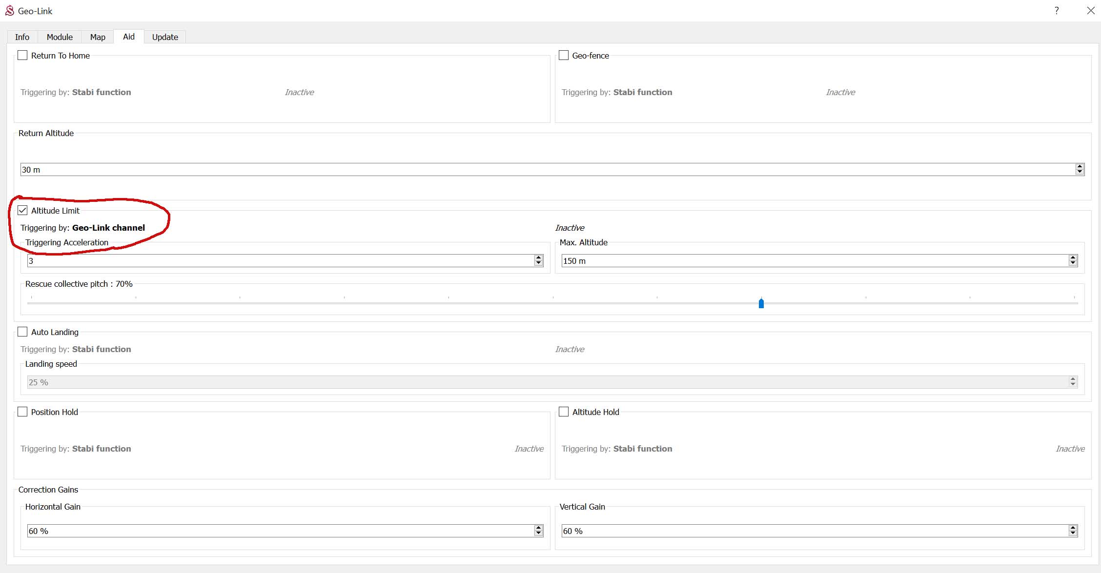

Now I want to show you:
now exit triggering by geolink channel while before during my old tests exit triggering by stabi channel
i read the manual but maybe I misunderstand.
If i use on1 my helicopter it should go up 2 or 3 meters and after am I in control again?
and repeats this every time I go under the quota set from the moment I activate the limit altitude?
If i use on2 the only difference is that is adjusted by channel the quote in which it is activated limit altitude?
But during my tests with on2 is activated every time I arrive at the quota in which I activated the function and it means that I misunderstood the manual.

on1 and on2 are the modes to activate limit altitude of the geolink.
Today I've done it.
I activate with f geolink limit altitude (on1) and stabi -functions i set selected by channel.

Posts: 13046
On 1 = you can define minimum limit directly from the time when you engage this function. Everytime you change switch position back to off and then on you are configuring new altitude for Altitude Limit.
On 2 = you can define altitude even if you are at the ground or in your home by changing channel value in other direction. There you will see in which altitude will trigger when function is active.

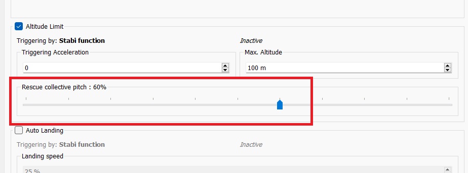

zex I have solved.
The limit altitude it gets activated and shashwplate went to the position set.
I had to decrease "Rescue collective pitch" at 40%.
In this mode i active altitude limit and the model go up for 1,5/2 seconds and go up of a few metres.
Now in this mode is perfect.
it's how I want it.
