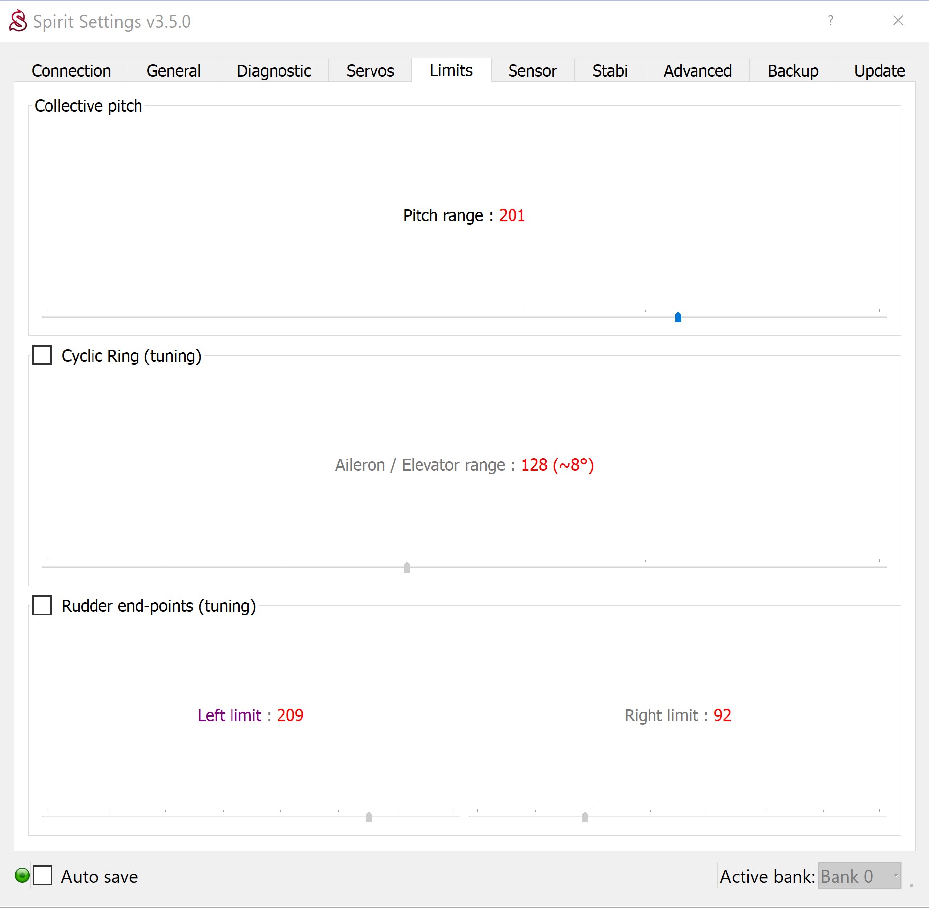

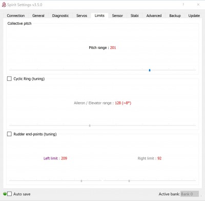

in the screen I see settings that are in my opinion not correct, but this is not your problem with rescue -
The values are way off in my opinion -
Do you have max. pitch of 15° ? That seems very high -
The cyclic pitch is 8° and thats for the collective pitch very low, I think it has to be 10 or 11° by the way -
Your Rudder limits are totally false 209 is way off ! The value has to be not magenta -
For this problem you have to put the linkage in the servohorn to holes outwards to reduce the values-

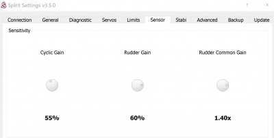

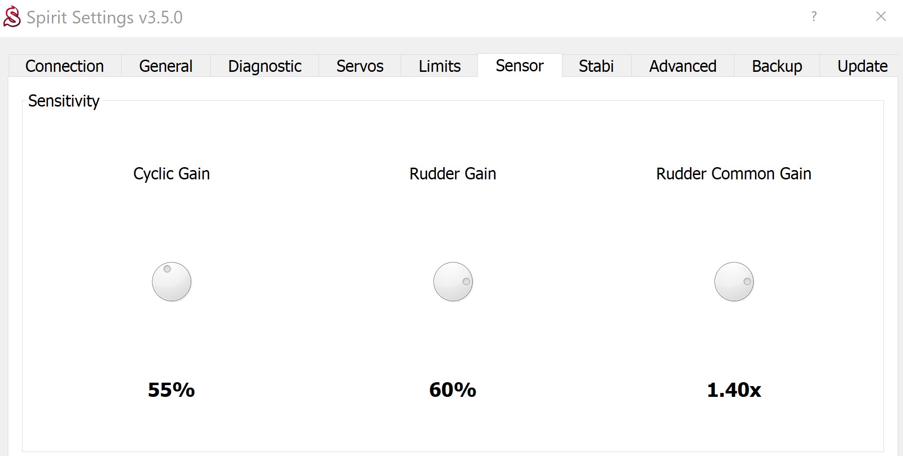

Why do you choose common gain 1,4 ? you can it easyly set up to 84° ?
I think that something is not set correctly here, because strangely enough, the maximum negative and maximum positive pitch is reached - I'm sure the problem comes out from the programming of the Radiomaster remote control, it can't be otherwise -

Ah, sorry about the increased collective, during troubleshooting it was suggested that I should increase the pitch to more than the 10% I have flown with. Cyclic I used about 8 degrees in flight. I forgot to turn that down after testing.
I'm aware of the tail setup being subotimal. The push rod is too short but is glued so I will need to buy a new one.
Your are thinking of rudder common gain being set at 1,4x? That is default (at least for the Logo 600 preset) and I haven't changed it.
