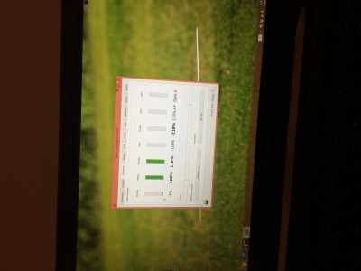

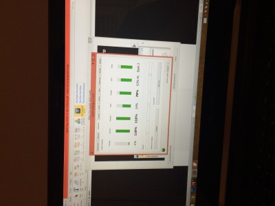

I took some pics of the diagnostic screen when the Tx is turned off and when it went crazy when I opened the log.
What is weird is if the heli is not connected to the computer the failsafe works perfect. I turn off the Tx and nothing changes, it keeps everything where I had it when the Tx went off.
