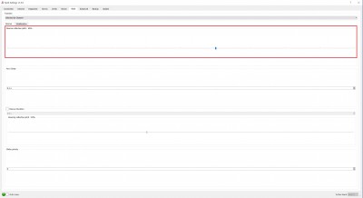

Excellent idea, I tried it but nothing happens when I change the value of P: Rescue Collective Pitch.

first set the potentiometer to maximum and leave it at the maximum point
and after active rescue (but from what I see it doesn't work)
or while the rescue is active turn the potentiometer and see if the swashplate moves
but if in this mode remains 0
NOT IS NORMAL
try to use the logs to understand maybe the logs themselves tell you the problem
