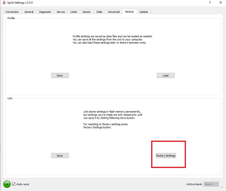

Can I know how do you do this procedure?
push button factory settings?

Posts: 12834
franz88 wrote:I have half an idea.
while spirit is on loctite has disconnected the servo plug while it was on.
or Why it was in spirit software it disconnected while it was open.
or one or the other.
This procedure can't be done by user normally or even shouldn't be done if you dont know what you are doing. If so then you can actually make unit to work incorrectly and can result in permanent failures. So doing it just for a try is not good idea.
