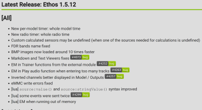

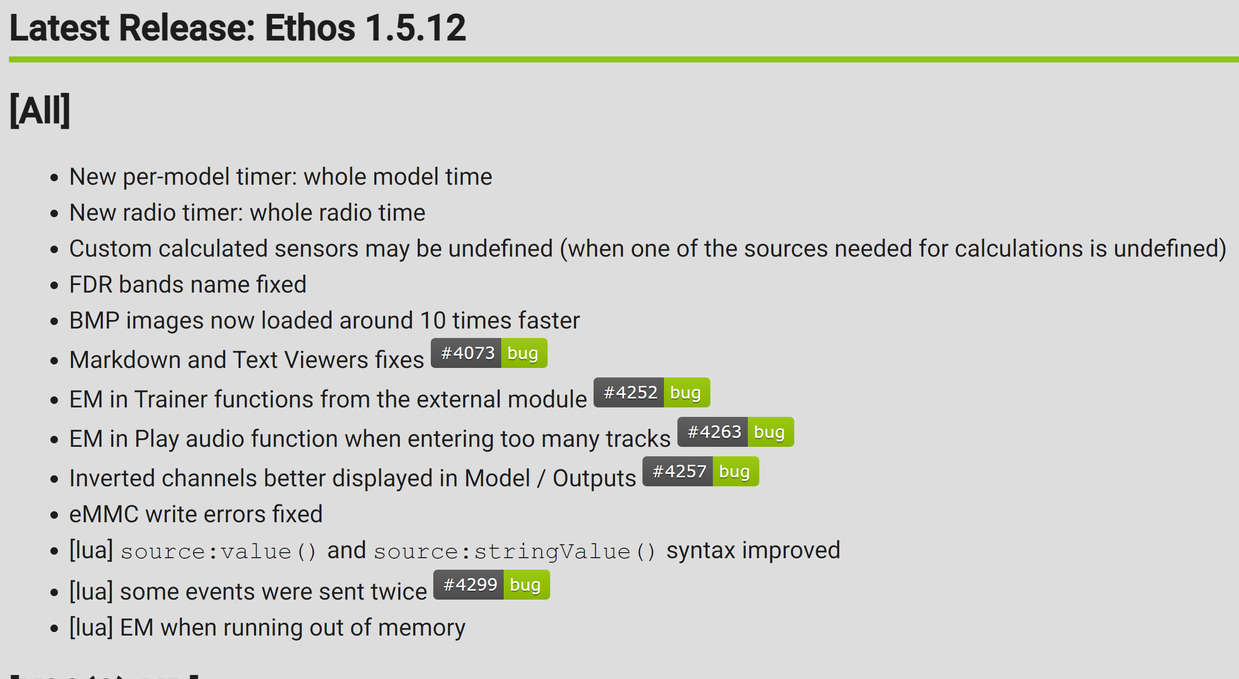

Additional information what has changed in ETHOS 1.5.12, I hope this helps too...
Best regards
Matthias

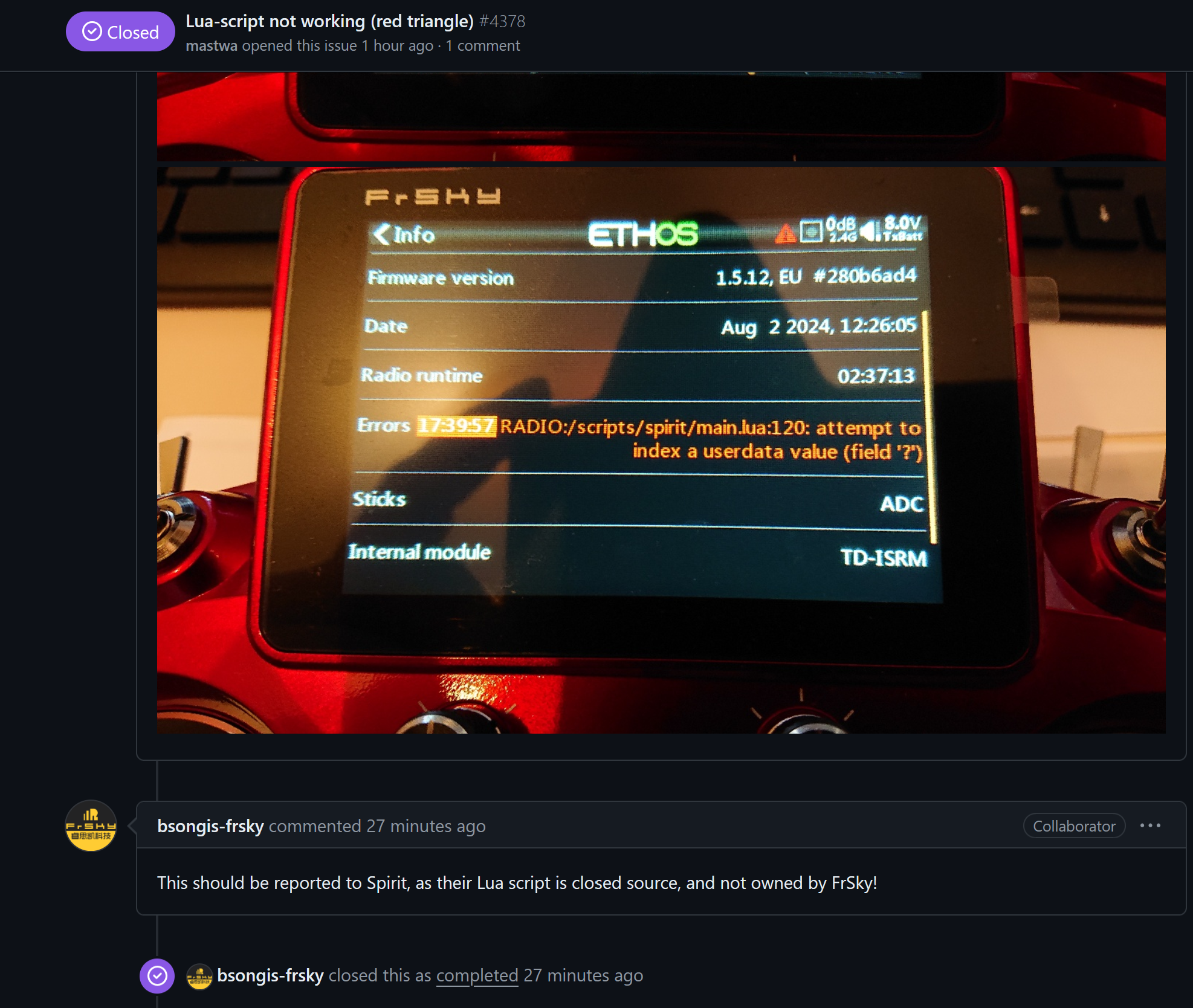

parallel I had this problem reported additionally at GitHub (FrSky) and received this answer from the developer:
Tomas, please change the LUA-Script that it will work again with this version -
Thanks a lot in advance !
Best regards
Matthias

Just for clarification, the red triangle was introduced recently and this way Ethos can tell you, that scrip made something wrong. But script is still running, like before. In my case integration script generates an error but still works. But I'm not on 3.7 in any heli yet.
azaz44
Posts: 288
Or in other words, this script error was there in the past. It's just that in previous Ethos version you wouldn't see it. To see it you would need to connect a debugger. Since 1.5.10 Ethos shows errors in UI, but scripts work like before.

yes you are right that the red triangle was introduced recently - but this means also, I read it in an other forum, that in this way it was avoided the transmitter going into EM mode -
Sorry mistake is a mistake and how can you be shure that the rest of the script works like it should ?
