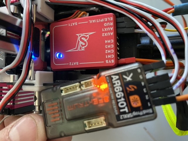

This is how I have to set up to get the stick inputs to respond although aileron does not show reversal in spirit software but does work on the Heli,
On spirit, is this ok ?
Red in sys
Esc in aux1
Brown/red to rud and orange to pit
On ar6610
Jeti cable to port 1
Aile to port 2
Ele port 3
Pitch to port6
Ar6610 latest firmware and spirit and setup software up to date

Well got to the servo trim setup page and the spirits blue light goes out, go back to diagnostics and it comes back on so obviously that approach does not work

Why have you got your servo's plugged into the receiver? They should be plugged into the Spirit....

Nothing happens they don’t respond to stick movements on the servos or in the wizard

1st,make sure you have updated 6610t to latest FW, then in spirit/ wizzard make sure you have receiver set to SRXL2 then follow the wizzard instructions and all will be ok...

Finally sorted and ready to maiden, one question where should I plug the single yellow Rpm signal wire from the hw platinum esc Into in the spirit ? I have the term uni cable from the esc into sat1 on the spirit and geolink into sat 2

So finally installed the 3.1.0 Firmware into Spirit Pro.
Spektrum AR637T receiver works now with Spirit Pro in SRXL2 mode!!! I had to put the Jeti Integration cable into Channel 1 (Throttle) on receiver and re-route the Throttle output to other free channel (CH5 - Gear in my case). I control my ESC direct from receiver.
Few tests with Jeti cable on AR637T side:
- Bind/Prg/SRXL2 - port works NOT !!!
- CH1 (Throttle) works in SRXL2
- small 4pin JST SRXL2 on top of AR637T works the same way too in SRXL2

@Neilsteers the RPM, yellow wire, goes to the middle pin on the elevator/Pitch/Aileron connector
