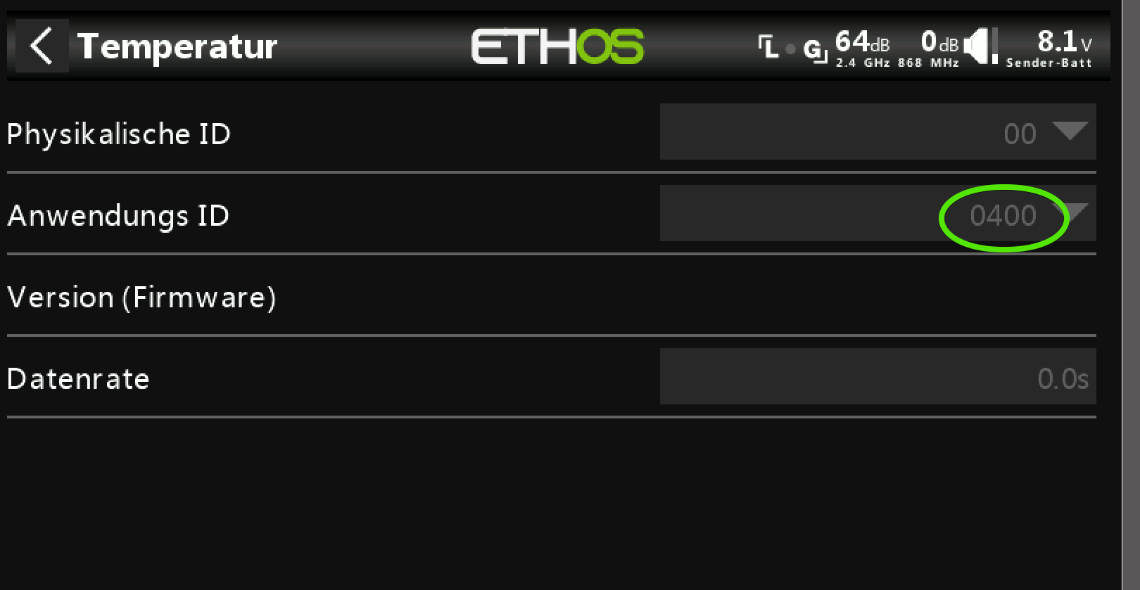

I got my FBUS sensor for the temperatures today and connected it. Immediately again sensor conflict messages. These messages came constantly every 30s.
I looked at the appIDs of the new sensor and found that Temp.1 from SPIRIT GT and Temp.1 from FAS100ADV have the same appID.
As far as I know this should not happen because Ethos only evaluates the appID for FBus sensors. But I'm not sure if this is really the case.

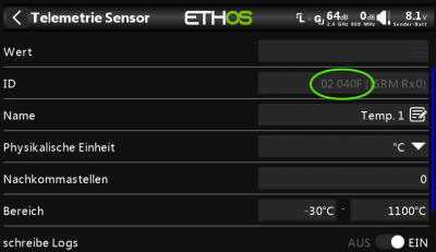

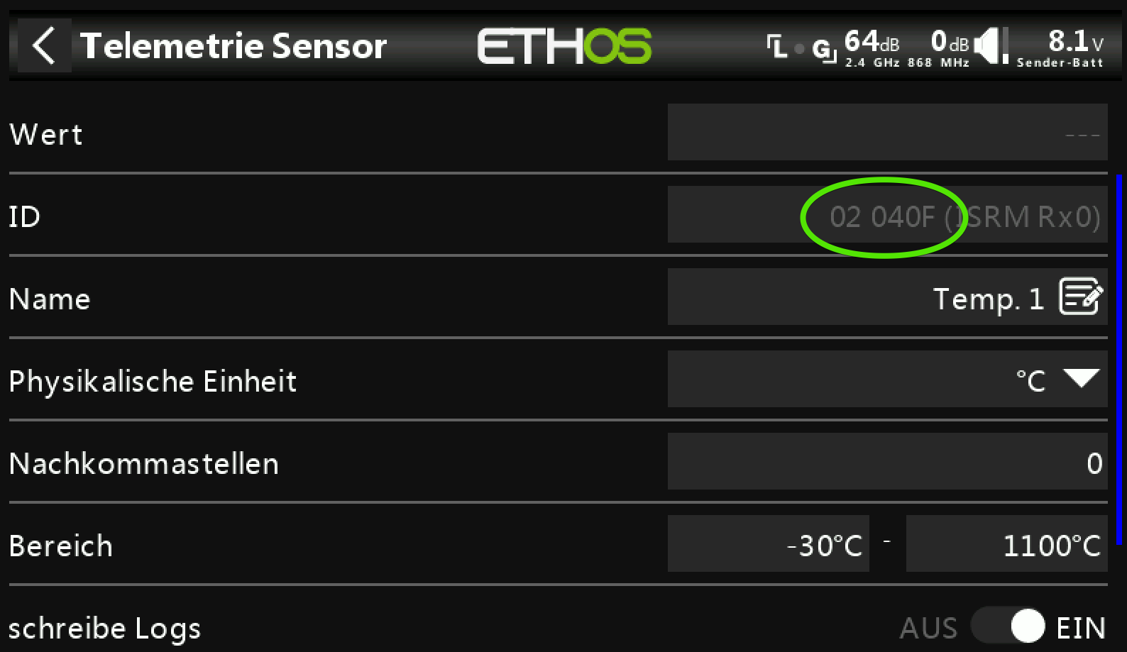

I have reconfigured the sensor FAS100ADV Temp. 1. Changing the appID from 400 to 40F.
Important: Now I turned off the receiver and deleted all sensors. Reboot the receiver and search for sensors.
Now I no longer get a message about a sensor conflict.
Thanks again for your work on the firmware Tomas.
I am very happy now and will go flying as soon as the wind dies down.
Ciao
Jörg

Posts: 13045
Thank you for the report.
It is interesting it is reporting as conflict, since both sensors are running as different PhysID. But likely FrSky wish to run all sensors under different AppID.
Storchy
Posts: 107
I have read this information on german ETHOS forum ( Engel) that you need different appID independent from the physID.
The physID is only for S-BUS Sensors. I cannot understand this, but now it works and this is the importent thing.
