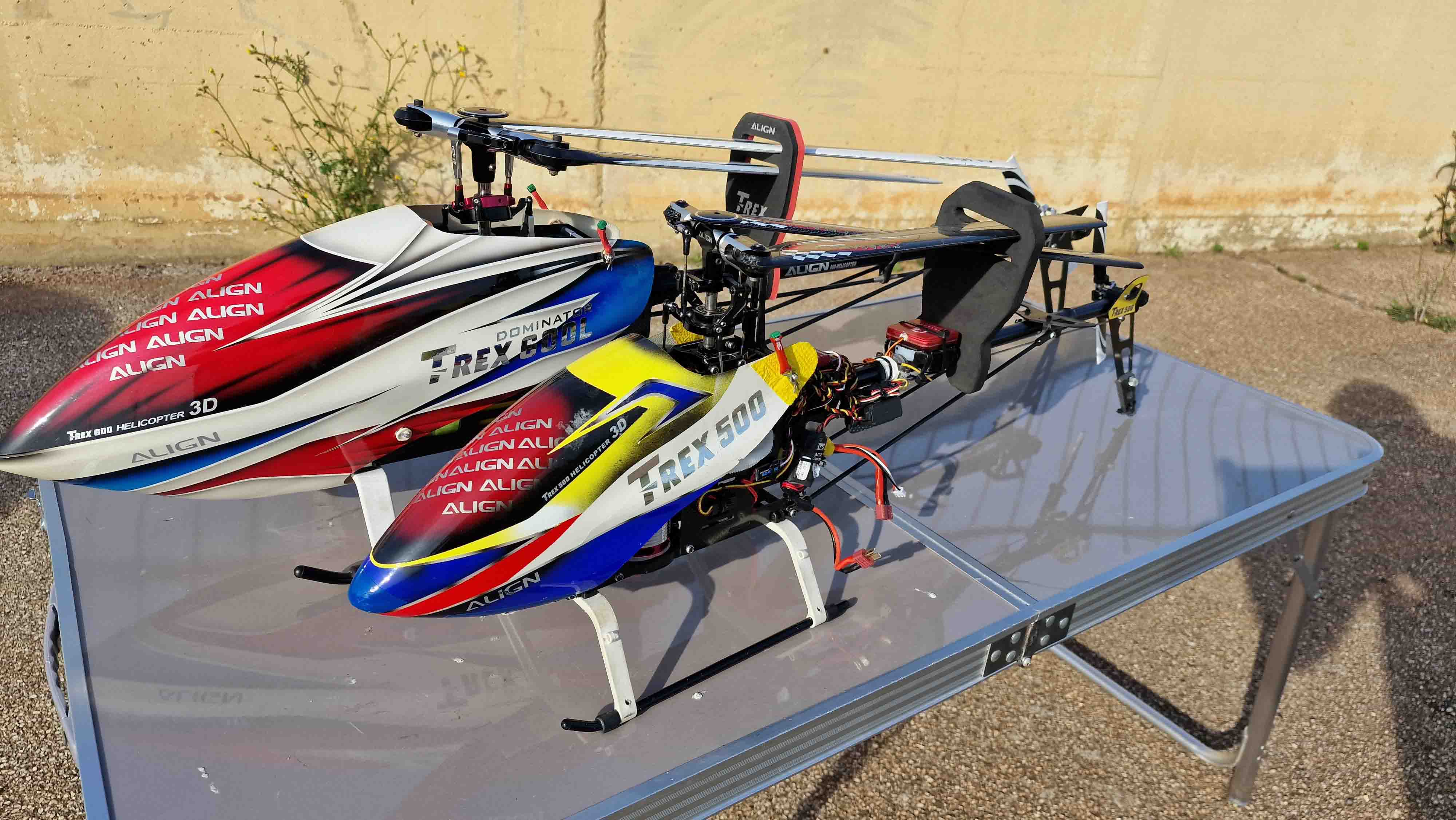

the thing is that this helicopter it was given to me.
Until today to make it fly I changed the 90% and the components and spent 500-600 euros.
and I always find myself an old model.
These vibrations come from the main rotor who has game on the axis that spirit calls aileron.
The pieces that I have not changed should be changed and get to the money of a new model.
If from the beginning I put that money into a new helicopter I found the new model.
These are models with a higher center of gravity and even changing the pieces it doesn't mean it rides like a new model.
My trex 600l dominator for 3d is fantastic.
But my trex 600l dominator it has lower tail ratio 3.85 and to fly well it needs many rpm.
We need models that run at lower rpm and above all with a lower center of gravity.

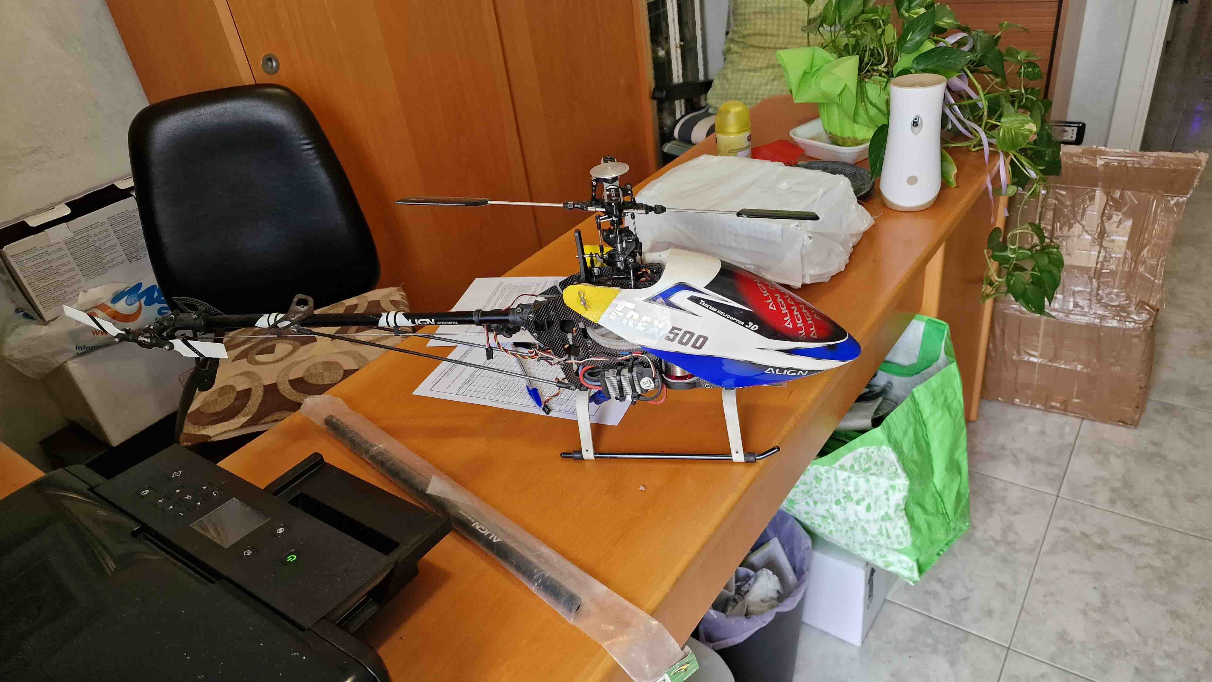

zex I'm redoing the head setup.
For now i aligned I serve perfectly at 90 degrees at the same time aligned the levers of the head.
After I will put the precise 0 degrees
this video it is private only with this link you can see.
But if you do a search the video will not come out
https://youtu.be/FS8oZ3KcYNo
I have to ask you something.
Usually the elevator servo it always gives me problems.
In your opinion with the three servos at 90 degrees and the three servo linkage perfectly equal (measured with digital caliper and compared to see the length) I must have 0 degrees precise ? (obviously with level plate)
Now I have to move the tie rods of the hands for have 0 degrees.
But in this phase you never have precise 0 degrees and to correct if i move subtrim tuning (software spirit) the 90 degrees of the servo moves.
In your opinion better to leave the precise 90 degrees or have 0 degrees accurate?
I measure in all 4 blade positions.
Blade on the noise, tail for movement aileron and blade left right for movement elevator.
Also i use servo travel correction-setup after for have 12 and -12.
i move servo 1 in positive pitch after move servo 2 in positive pitch and servo 3 in positive pitch and i move (at max stick) for have exactly 12 degrees.
the same for the -12 only that you move the stick to the min and move slider negative pitch.
Why you can never get the exact degrees

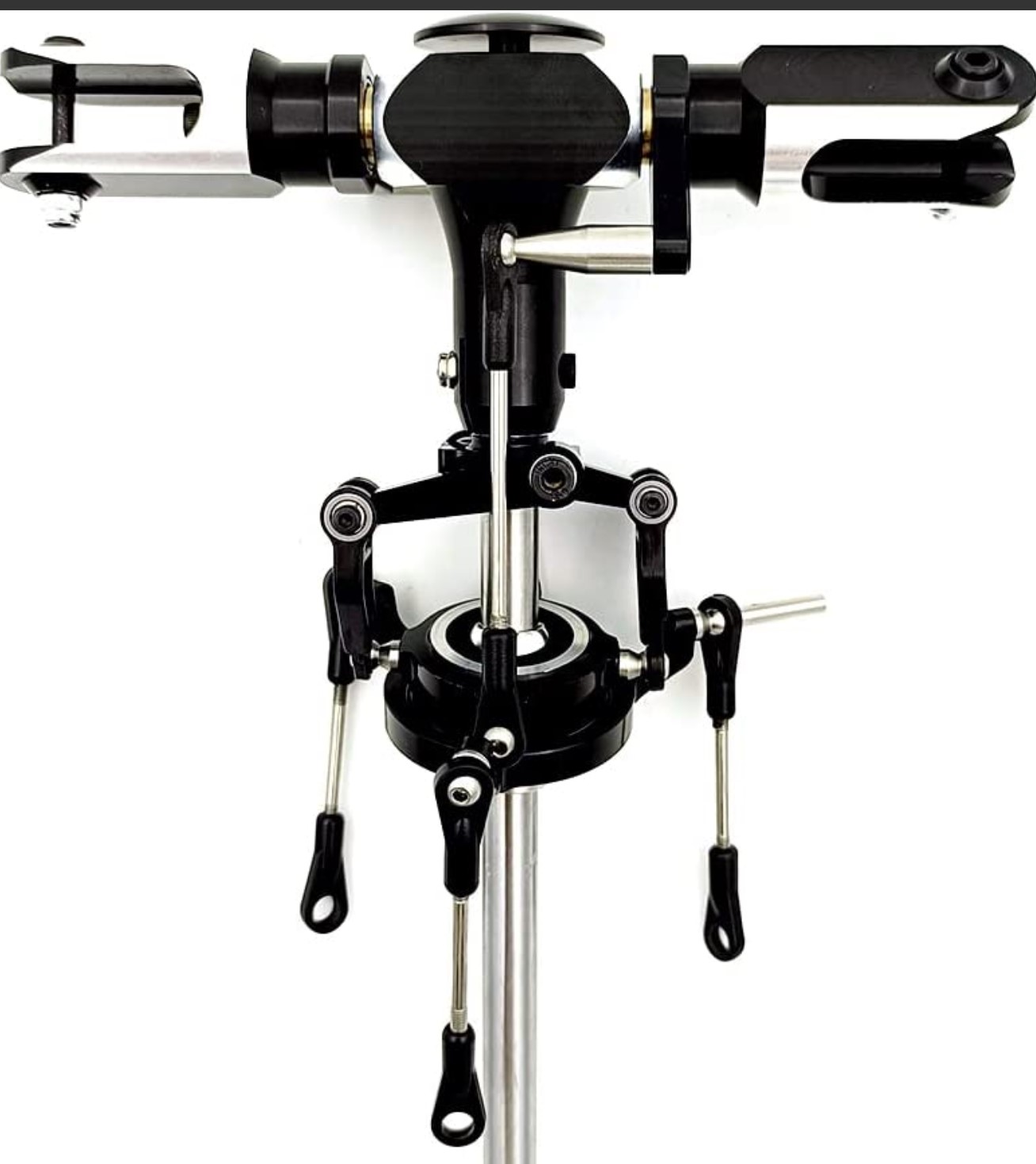

After watching the video, there are some things that should be checked.
1. The links from the servo arms are not perpendicular to the servo arms. You should move them one whole closer to the center.
2. The links from the blade grips to the swash, again are crooked. Are you using the correct length ball ends?

To franz: vvv850 he is right about everything
And as I already wrote, your fbl head is wrongly assembled, the leaf grips should be on the leading edge. There are a million photos and videos of how to do it right on google.
Posts: 638
Hello Franz88,
sorry for saying that but your head is absolutely false built ! This coulnd't looking bader after a crash, this is really all bend -
The the bladegrips have to be mounted to the other side ! I don't wonder why this doesn't fly good -
You must urgently change that because the next damage is safe !
Danger to life and limb is given ! Don't fly this !!
So should it look like, without bending and this is a Align head (Align Trex 500 PRO):

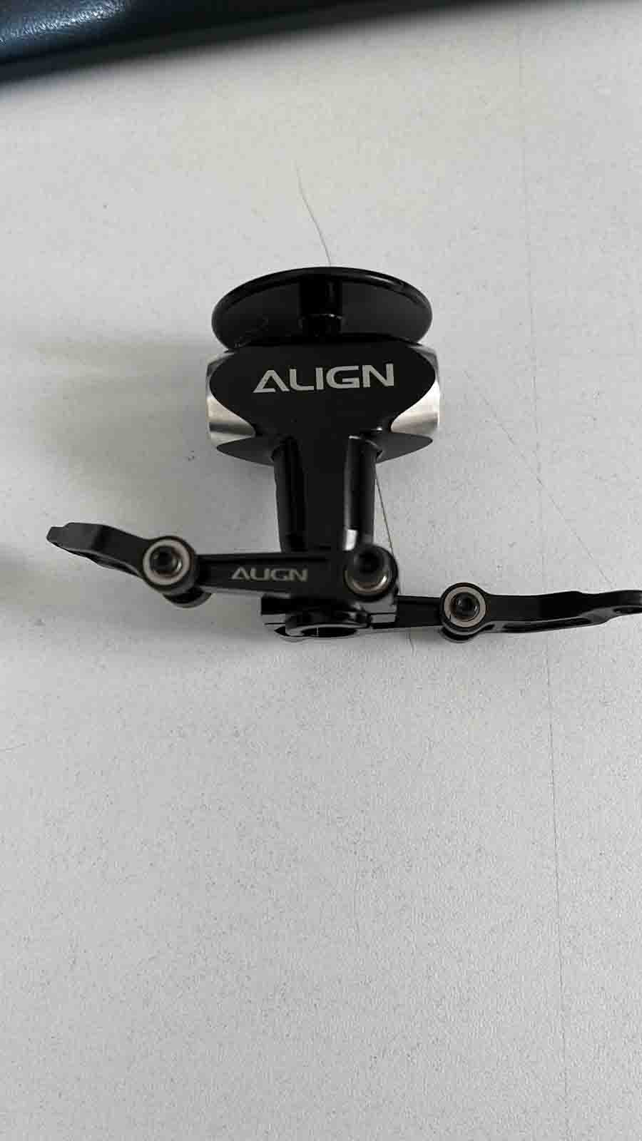

franz88
Posts: 343
yes you are all exact.
is all exact.
Now I'll explain
Only this model it was mounted in this mode why before I had this head.
after I bought these pieces (all out stock, I was fortunate to find her)
it has become as you can see, that is a typical swashplate with pitch reversed.
Usually hands they are rotated 180 degrees , but I rotate my hands 180 degrees the linkage rod from the swashplate to the hands tap the t hub screw.
many helicopters use the inverted swashplate, but if you think there are models same as the blade 230 who use this type of swashplate
as you can see the dominator is mounted well
I should buy the hands of that head to fix that thing.
I saw that it was fine and left it.
But if there is a need to change it I will assemble those hands, that shaft and those bearings.
In italy pieces for this model they are hard to find for out stock, I don't know maybe align seems to have blocked the supply of spare parts

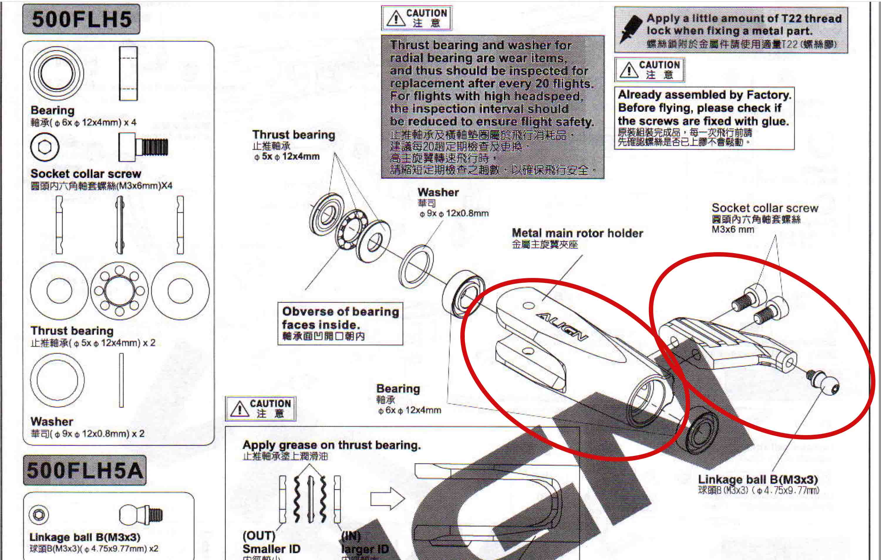

I just need to find the metal main rotor holder and the bracket, only this 2 component (the rest of my pieces are all new and compatible)
the component of trex 500 efl and i resolve direction of the pitch and direction 180° and in this mode spirit receives less vibration.
i can't buy them for out stock

Posts: 638
Hello Franz,
yes it is really complicated to get new parts indeed -
Maybe I have foud at least one part:
https://www.freakware.de/p/500efl-pro-b ... 116563.htm
or
https://www.rcheli-store.de/RC-Helicopt ... 35&p=41235
Not sure if that is the correcct one but it could be:
https://www.rcheli-store.de/RC-Helicopt ... 80&p=11680
Both companys are sending parts worldwide...
I hope this helps -
