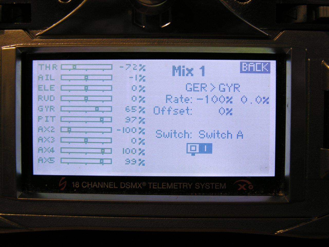

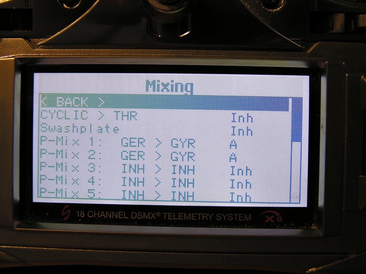

Hi guys may be you can update the manual for the DX9 the recovery
Is easier to set up using Mixing and putting it onto the Trainer flick switch
Both mixes are set up the same this will give you recovery in all flight modes
