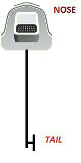

[attachment=-1]uploadfromtaptalk1457980411247.jpg[/attachment]
[FACE WITH TEARS OF JOY]
- uploadfromtaptalk1457980411247.jpg (5.95 KiB) Viewed 8964 times
