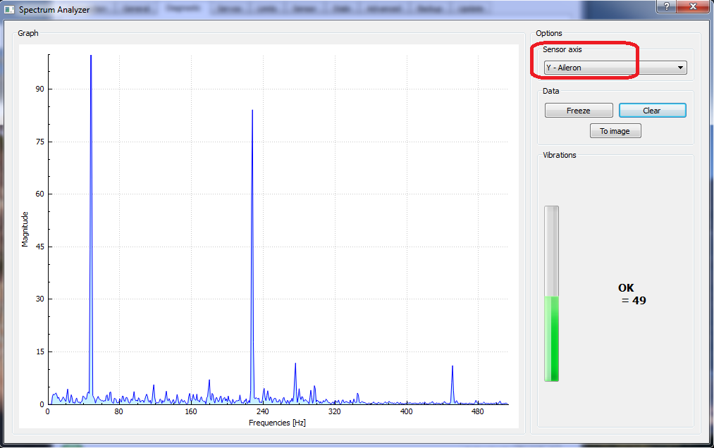

While upgrading to V2.0.0 I also played a bit with the Spectrum analyzer. (Great tool.)
It gives me some vibs only on the Y-Aileron axis.
Why only on that axis?
Does that point in a specific direction for trouble shooting this issue?
Sometimes it goes a bit over "50" and it shows "increased vibs" or something similar.
The heli (Gaui X3) seems to fly fine to my knowledge. :mrgreen:
Should I worry or just go fly?

Vibrations are mostly transfered to the Y axis because of custruction of the frame.
Generally you can tell that helicopter is OK if any spike will not exceed 50% amplitude.
Unfortunately first spike is exceeding 100% which is not really good.
First spike is from the main rotor and it look like a bent main shaft, bad bearing is less probable because spike is very precise.
Second spike is coming from your tail mechanics. There could be same issue.

Not sure why the peak is so high on the picture, the numbers only show slightly above 50.
After the last crash I replaced main and tail shaft.
I know they are perfectly straight.
Flying with a bent shaft I would certainly notice. (Not the case here.)
Could it be the steel pinion on the main gear (very hard plastic) transferring some vibs into the frame?
If I put my hand on the heli while spinning at high rpm, I don't feel much vibs at all.

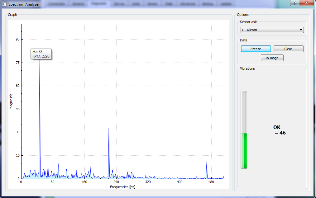

For fun I added a small piece of electrical tape on one tail blade.
Wow, amazing!
Spike is a lot lower. :mrgreen:
(On my first post tail blades are also connected.)
Tested with rudder servo disconnected and tail blades centered.
For the Spectrum analyzer it would be handy if it defaults to the Y-Aileron axis.
That page shows the spikes.
On other axis it's almost nothing.
Small piece of tape on one tail blade.
