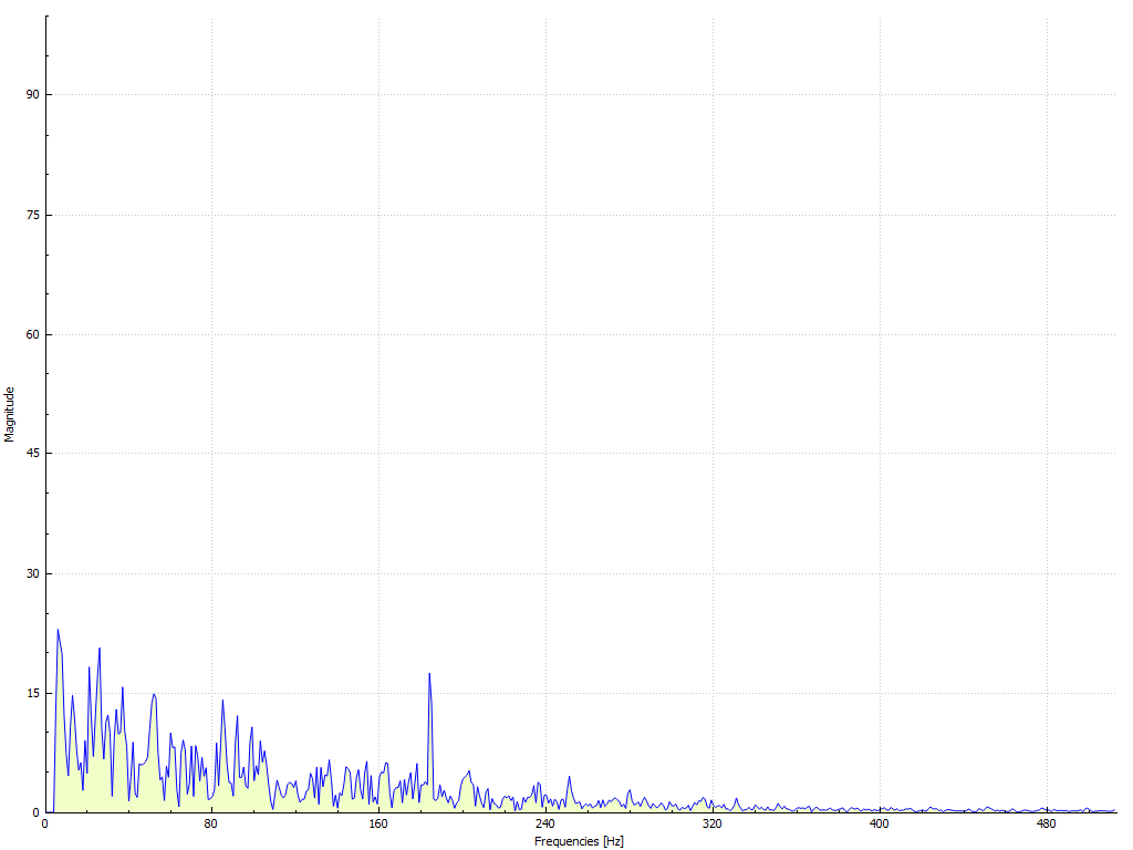

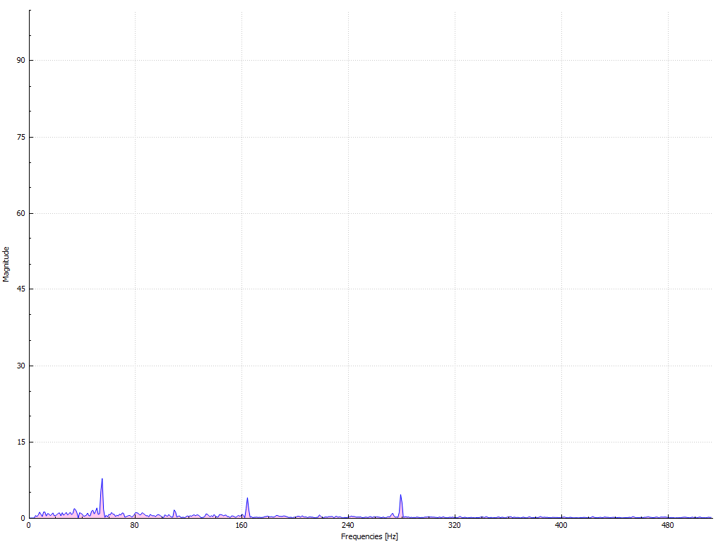

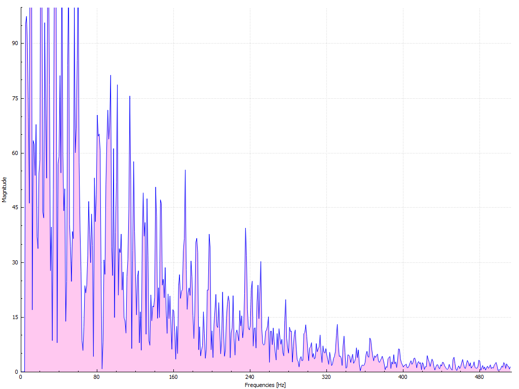

So today I did some tinkering with the Spectrum Analyzer and found something interesting. My tail (Z Axis) is showing massive vibrations (316-350), and vibrations of about 63 on my X Elevator axis, with 9-15 on my Y Aileron but when I disconnect the tail belt from the main shaft it goes below 20 on all three axis.
This is the Z (Rudder) axis running as "normal."
So I'm pretty sure the vibrations are in the tail, but I wanted to check with you guys and see how you would proceed and what I should be looking for.

This is the Elevator with the tail belt still attached.
This is the Z (Rudder) axis with the tail belt detached from the main gear.

I found the issue. I had installed SAB's belt tensioner and while spooling up I was looking over the heli and noticed that the tensioner was jumping around a bunch, so I took it off and everything is below 20 on the whole heli.
