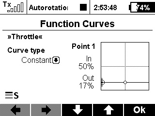

I just reset everything again - not much change in the sense that my throttle curves to get the right RPM now require 19% and 20%. While I was looking at the throttle curve UI in the Jeti I wondered... when setting a throttle curve in the Jeti, I use a constant value - the following is what I set for Autorotation (e.g. normal mode):
autoro throttle value.
Am I correct in interpreting this: the throttle value is a constant, and it'll always be 17% of the input? OR does this mean, the output will be 17% of 50% of the input, e.g. if I put in 70 then the output will be 17% of 35 (50% of the input).
Guess I need to read the Jeti manual again.
If anyone has a great explanation of how to read/interpret the throttle function curves - that'd be awesome.
