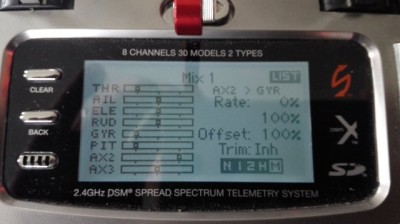

Coco66
Posts: 433
So this should work. I did not test on the Spirit but looks fine in the DX8 Monitor.
Please check very carefully in Spirit Diagnostic that it gives you the desired result.
1) go to Switch Select and assign AX2 to your Rescue switch (I suggest you use the Bind button, physically relocating it to the side, as you can see in HF, but any switch - possibly 2 positions - should work)
2) go to Mixing, scroll to Mix 1 and change it like this:
3) Test in DX8 Monitor. If you did setup the F-modes like you said, your Gyro channel should show -100 when you are in Normal and IU1, and 0 when you are in IU2 or in Hold. While the Rescue switch is pressed, should show +100 when you are in Normal and IU1, and +150 when you are in IU2 or in Hold (this will work same as +100, no worries, it will select Bank 2)
Zed
