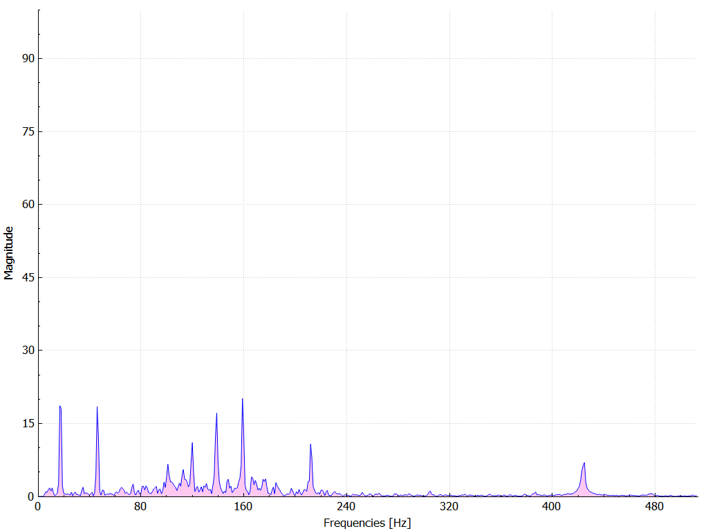

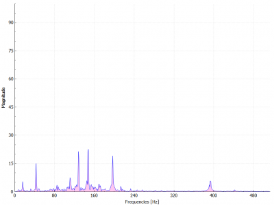

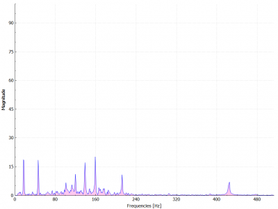

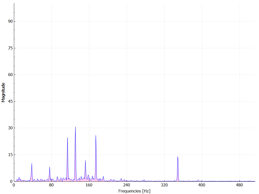

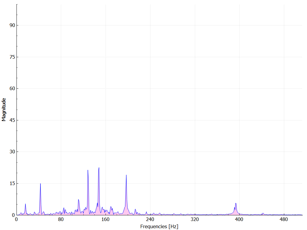

Z-Axis vibration, please see attached pictures (different RPM)

The plot that you have posted looks good - not completely good, but there is nothing major.
It looks like there is some small bearing issue in the rudder. Then you can see spikes on the rotor head, more on the rudder mechanics and very slight on the motor.
If it is really a bearing, then it might be worse during flight (when it is heated).
