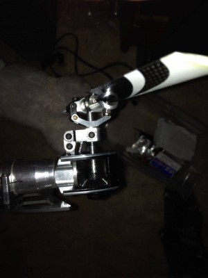

Any suggestions would be appreciated. The tails are set up exactly how they're supposed to be per Align manuals. If you power up the heli and give no stick inputs, the tail servo arms are 90 degrees to the boom, and the tail slider hinges are straight/90 degrees to the tail shaft.
Also, on the Trex 550 dfc pro (600 boom), my tail travel adjustments are extreme and it's telling me one direction is too much. Those are the values I have to set to get full travel using the exact setup in the align manual (tail servo horn ball is in the third hole out 13mm). I've tried moving the ball to the fourth hole and it helped somewhat, but I still had to add a ton to the travel adjustments. Around 125 on the left side of the setup screen and 250 on the right! The mechanics on the 550 are odd.

From the photo travel range of the tail seems to be nearly equal. So it is very strange that you can see so big difference in the end points.
It looks like on one side servo arm is in so high degree (more than 45°) so changing it even more is making very small difference.

I did try using the 4th ball hole (16mm?) on the horn on the 550 and it allowed me to screw my links on the tail rod back to a safer length, but it did not make any difference to this problem.
