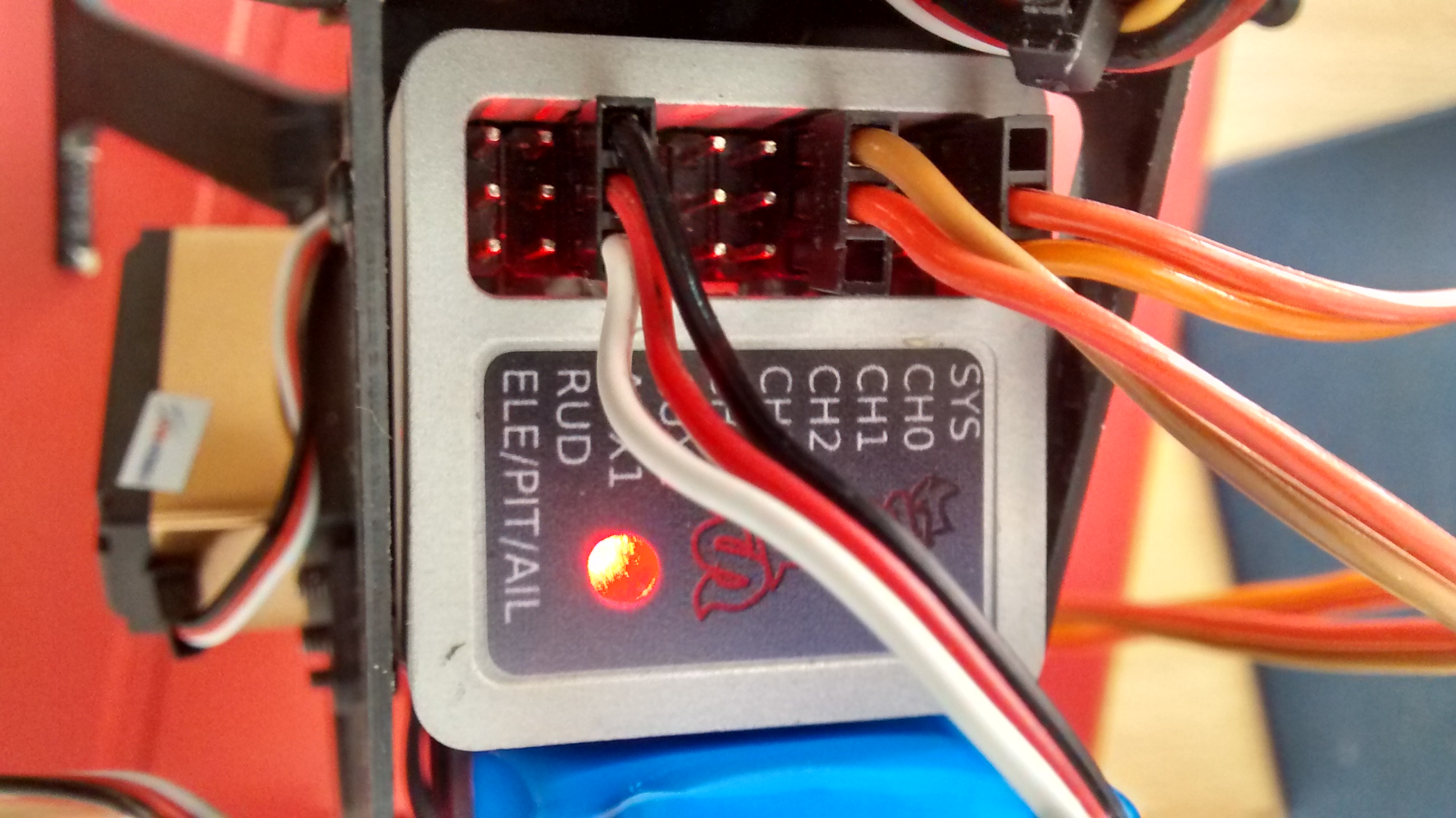

No worries. Can you take a picture of how it's connected to the unit? Probably it's not hooked up properly.
Heli1458
Posts: 10
Joined: Fri 02. Sep 2016 6:28:46
I have only connect to Power, Power and TX/RX for Wifi-Modul.
there is no Receiver, Sattelite or Servo connected.

Posts: 12921
is the same power supply (battery) connected also to the unit?
When you power up the unit, can you see initialization procedure - pulsating status LED?
This should take a few seconds and then LED should be ON all the time.
You have to wait until the initialization is complete, then it should just work.
Your connection seems to be correct.
In the Wifi-Link Spirit Settings it should work immediately, if version in the unit is also 2.1.0.
If not, it should still connect and you will see error message "Version mismatch".
Also Android app will tell you if there is a wrong version. So definitively it should connect.
Are you sure that the original owner didn't sold you damaged unit?
Each unit has USB interface, so there is no reason why he didn't sold it as well.
