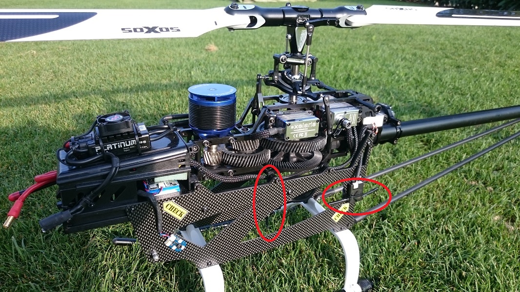

I use DSMX sats on my Soxos 700 with no issues. On on Sat on right side with antennas pointing up down (vertical) and other Sat on the left side antennas pointing front back (horizontal). Installed the way, antenas are not covered by carbon.
I do it this way an all my helis, see Soxos 550 left side.
