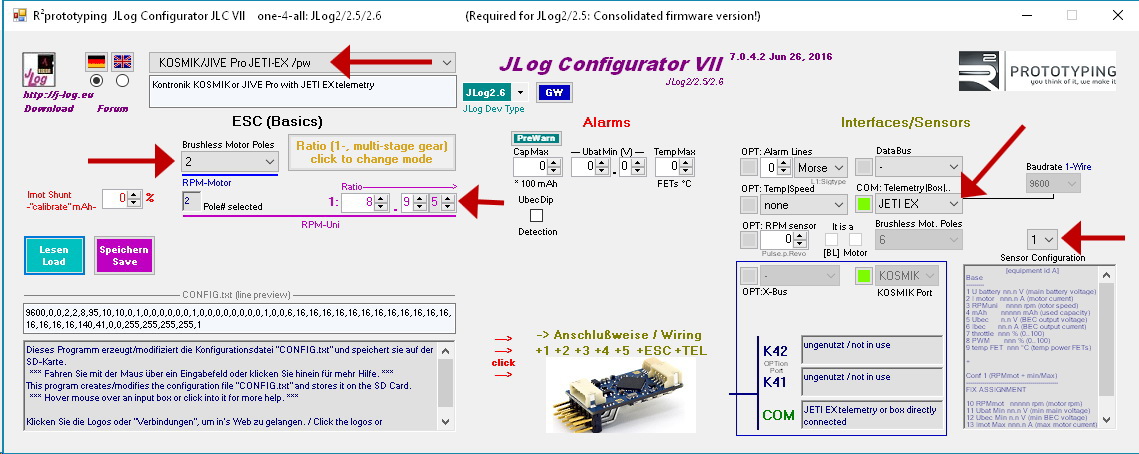

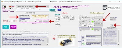

I use JLog 2.6GW with my Kosmik 200. You need the right JLog Firmware for that and some settings in the Kosmik and Jlog.
You can connect the JLog to the REX receiver to the EXT-Port.
Spirit goes via EX-Bus to the E1/E2 Port.

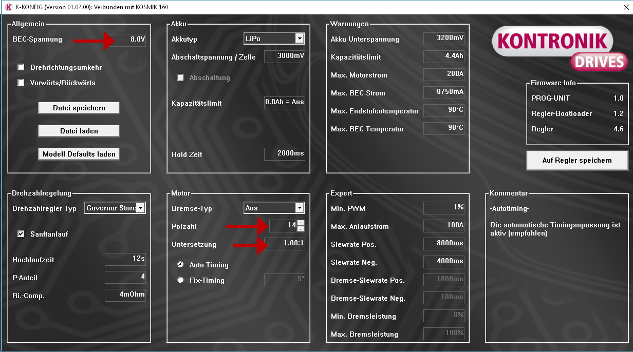

Kosmik Settings:
BEC Voltage > 7,7 till 8V
- 7,7 volt = Lipo is all the time on storage condition. Good for the Lipo, but less mAh
- I would suggest, Use 8 Volt with a 450mAh or use 7,7 for a 850mAh
- precharge the Buffer-lipo to the chosen voltage (only if empty)
pole count > ?
Gear ratio > 1.00:1
