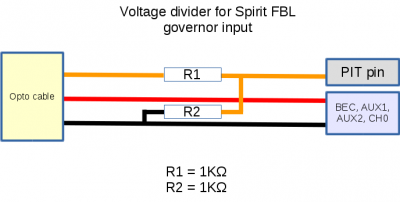

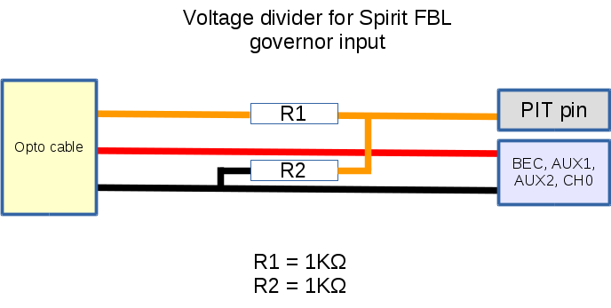

Posts: 12866
You will need to connect black(brown) and red wires to a power supply (BEC) as the ESC has no BEC.
If you are using HV BEC voltage I also recommend to use a small mod. It is quite same as for the VBar.
Please see my scheme. This will make reading more stable and also more safe.
