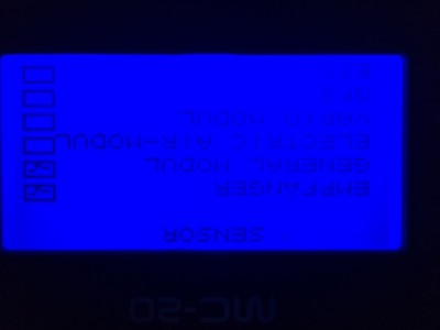

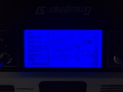

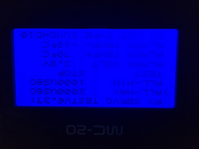

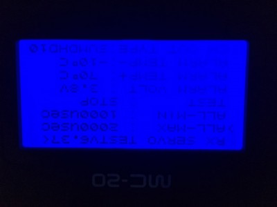

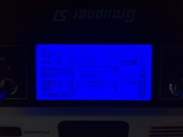

ok, I´m trying it in this moment. The first page in the telemetry menu is rx data, next is rx servo, rx fail save, rx free mixer, rx curve, rx servo test and that´s all. There comes nothing more..
Here some pictures. Sorry on my Mac they where on the right side :roll:

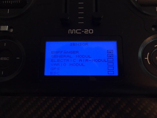

ok, i tryed the steps you wrote but i can´t select or deselect any sensor in the menu "telemetry/sensor select". It shows me the selected RX and the GAM. It´s curious because the Graupner Manual says that you can do so... :?: See attached picture
In the Sensor/Data View menu i also can´t switch from RX to GAM... In the telemetry display (the upper one on the TX) i can select RX or GAM to view the data of the choosen sensor.
I tryed to rebind the RX with and without any sensors but it didn´t change anything. :cry: I think i´m doing something wrong because the TX knows about the Spirit as the GAM.
Posts: 12988
you have to always go to the Setting & Data View and then by up/down arrow select General. Only when correct sensor is selected, you can see that new page (Spirit) will be available.
By default it will return to RX, so you have to always change the sensor.
In Sensors menu you can see only available sensors, but can't switch it.
