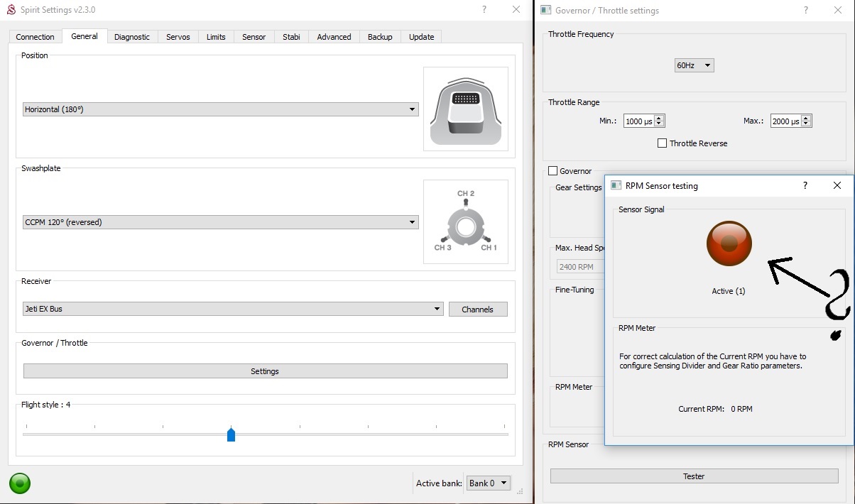

Hello
What is the meaning of the red button in sensor testing?
Does it have to be red or green when Gov is active?

this button is normally red, but when RPM sensor is connected and signal is High then it will change color. When RPM signal (voltage level) is low then color is changed to white (Status - Inactive)
Depending on the signal, you might see changes even during motor rotation by hand.

So I tried this on the goblin 500 with HW 100a v3 rpm out and while the RPM reads properly the indicator stays grey! Software bug or do I have a problem?
Posts: 12866
Some sensors are outputting the high/low level as a tiny spikes, so the software may be not able to check fast enough that the signal was high/low.
Probably we will update it little bit so it will be well visible in any case.

ZeXx86 wrote:Some sensors are outputting the high/low level as a tiny spikes, so the software may be not able to check fast enough that the signal was high/low.
Is the sampling rate the same on the Spirit and Spirit Pro?
Posts: 12866
Yes, completely same.

When are you going to fix this problem?
Posts: 12866
Hello.
With the upcoming update.
