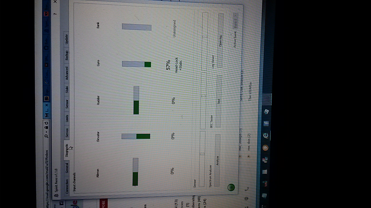

If the Self level stabilisation is active, then you have to see in the Diagnostic tab that there is Head-Lock + Stabilisation.
If you can't see Stabilisation, then the Self level is not active and normal flying mode is engaged.

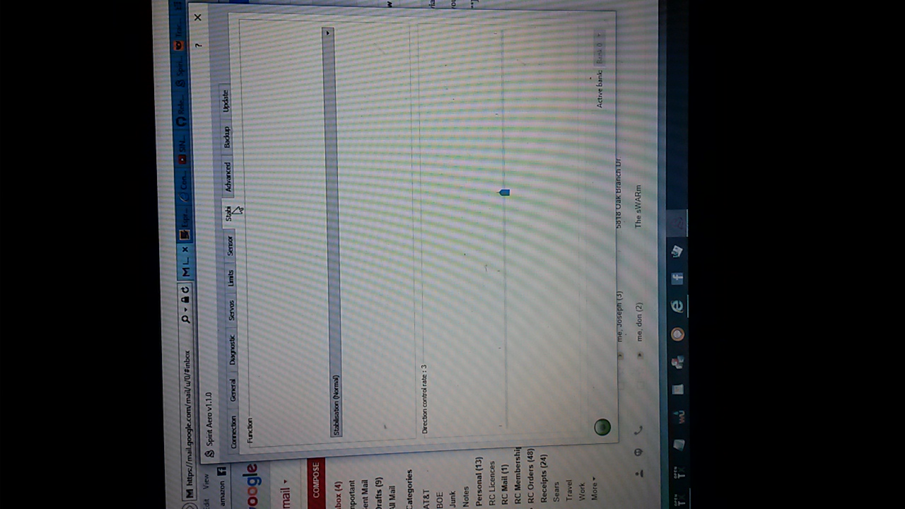

Make sure that you have Stabi/Function configured to the Stabilisation.

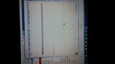

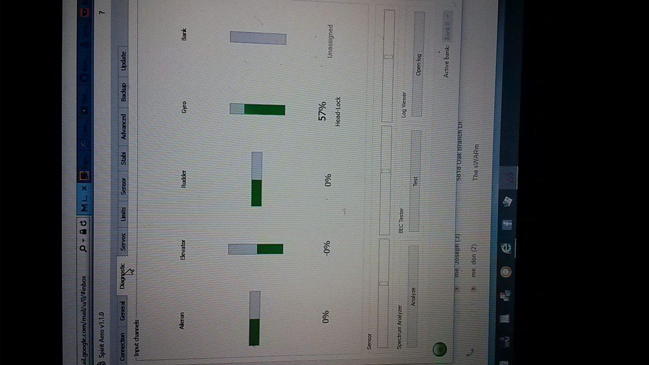

Hey ZeXx86, followed your instructions! and BAM!! Working in SLM as advertised... it has taken me a bit to get my head wrapped around it... you have been GREAT! Thanks You.. I've got it installed in a test plane.. a Millennium Master, will test fly soon but all looks good... Here's a couple of screen shots.. seems to be reading the ch5 gain fine now, made some adjustments to the curves the sliders are using. Thanks, Bob
