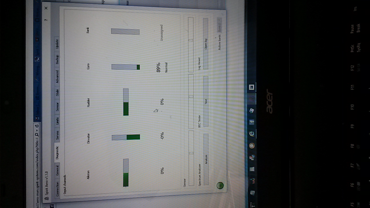

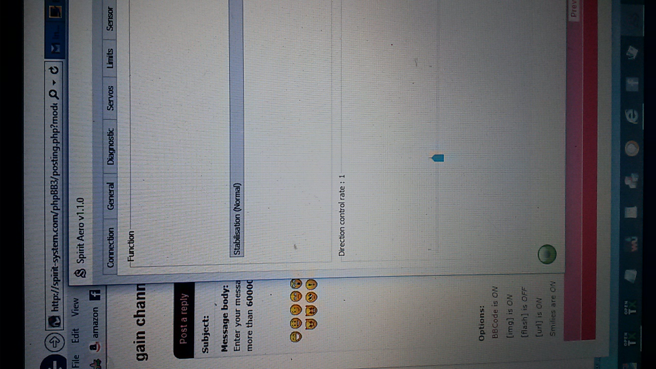

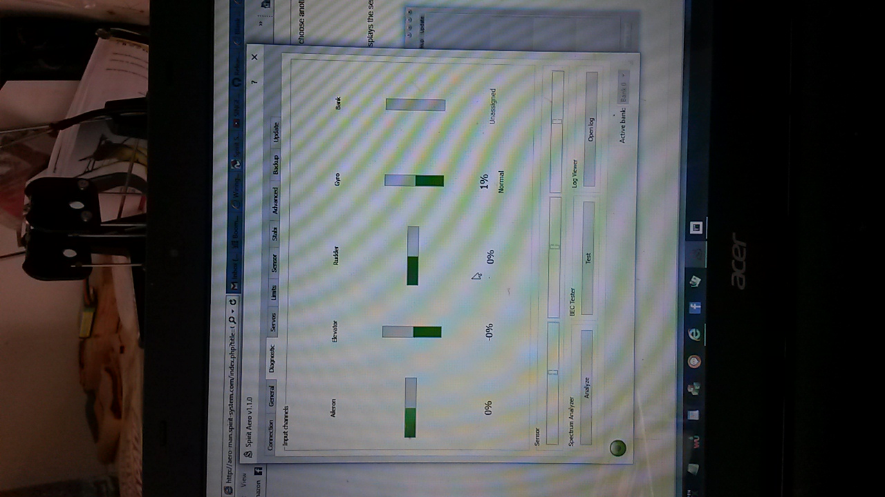

Hmmm... I don't have the F: Stabi set... I also do not have the "Bank" mode switch set up... when the program is running and on the "Stabi" tab it just shows Disabled and Active bank selection at the bottom is grayed out.When looking at the Diagnose tab... I never get "Head-Lock + Stabilize" ,, here are some screen shots they may help you figure out what I'm doing wrong.. really the only channel I have setup is ch5, tried it on a switch locking the setting to the + side or - side... or directing it to a slider R & L the left slider moves ch5 from -1 to -100... R slider 0 to +100... Do you have a Tx you can load and look at OpenTx 2.2.0 .OTX file (no longer using the .eepe) I post it here! anyway... below are some screen shots... if there is a screen shot that would help... let me know and I'll attach it!
Thanks for your help... I really want this to work! Bob
ALSO... if you notice in the channel 5 screen... it never shows a negative gain? even though my Tx is going to the negative side of 0 ???

Posts: 12988
Thank you for the screenshots!
Now I can see, that you have Stabi/Function configured to Disabled. This mean, that that Stabilisation can't work, because is not enabled.
You have to set Stabi/Function to Stabilisation as I have described earlier. Then everything will work.
Also I have described in other thread, that you will not see negative value, because it is displaying value that will be used for the actual mode you can see (Head-Lock/Normal).
So solution is just to set Stabi/Function to a Stabilisation mode.

Ahhhh... I think I know what your saying... maybe... do you mean like this... I thought I need to have "bank switching" on for that... I will load these new setting and see how it works... Still not sure why the ch5 gain moves erratically... maybe this will help... thanks

after following your advise and making some adjustments to my curves controlling channel 5.. seems to be working normally now! Thanks, Bob
