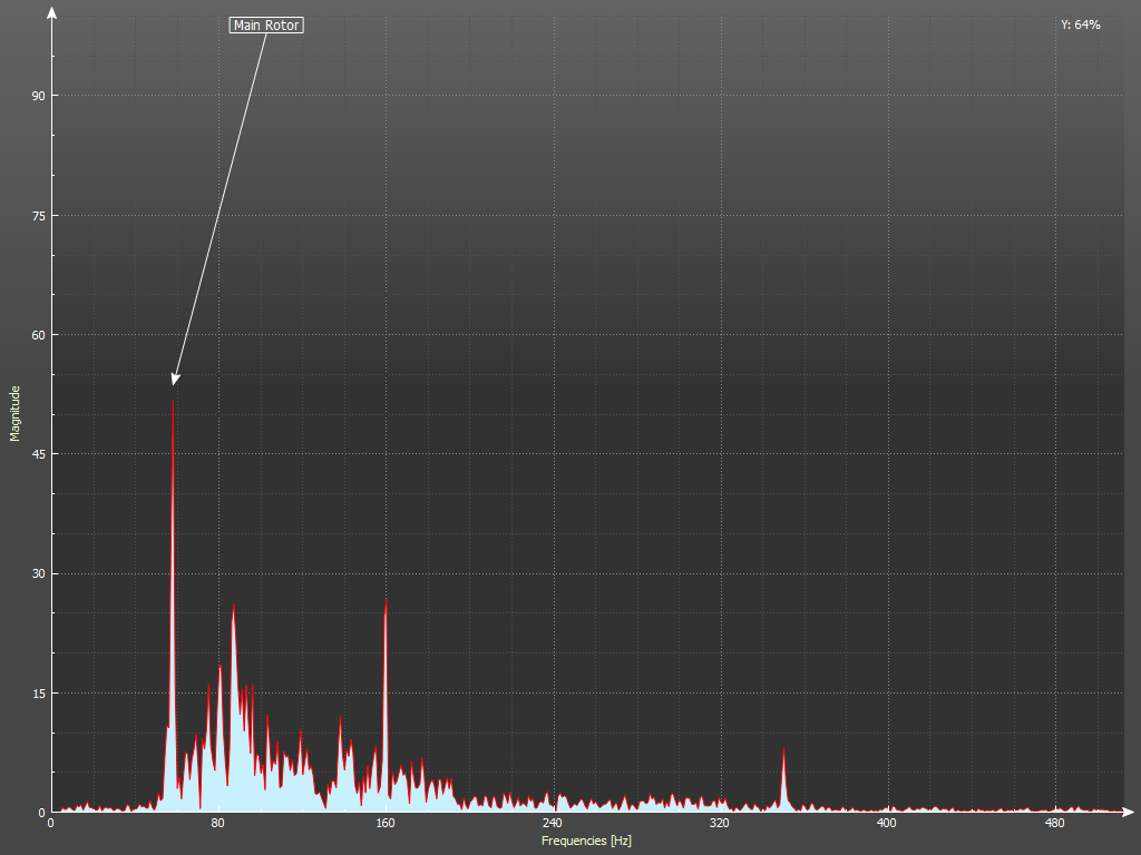

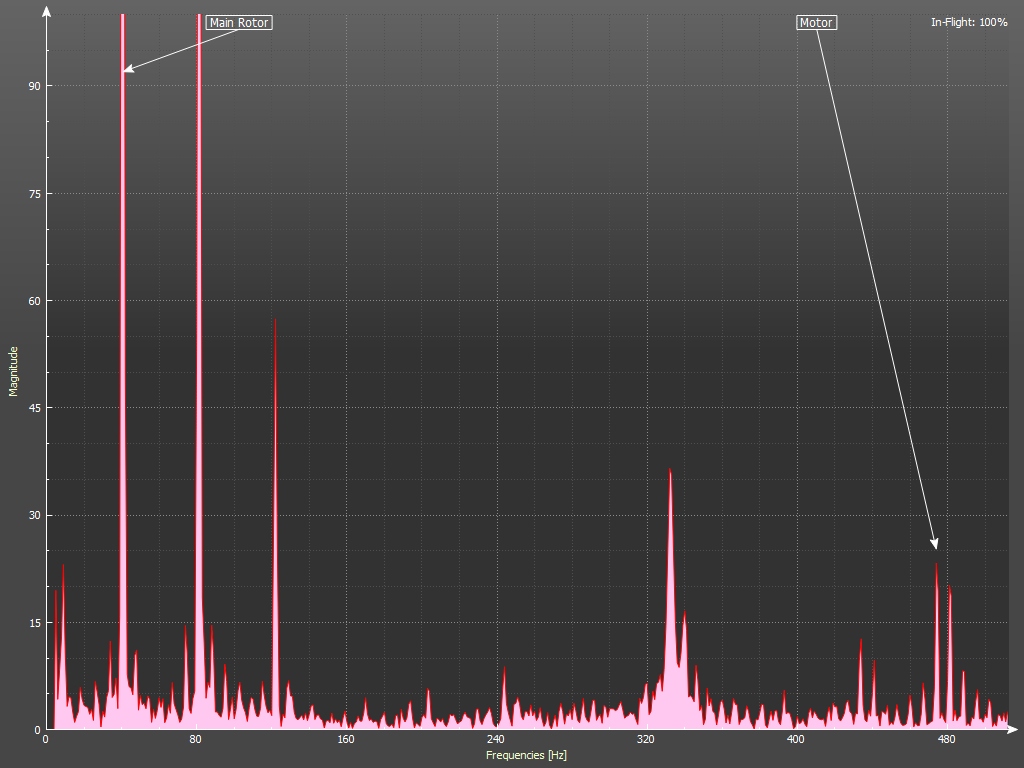

I have attached in flight vibration analysis it's high but is it TOO HIGH ?
If so I start looking for a solution.
Thanks Tomas
Posts: 12997
Well, it is not good.
The biggest issue is that there is some resonance vibration which is causing spikes all over the plot. This is the worst type of vibration.
It is one which causes buzzing or some noise that shouldn't be there.
Apparently the biggest problem is on the main shaft.
Normally no spike should be higher than half of the plot. This one is probably at 400% :)

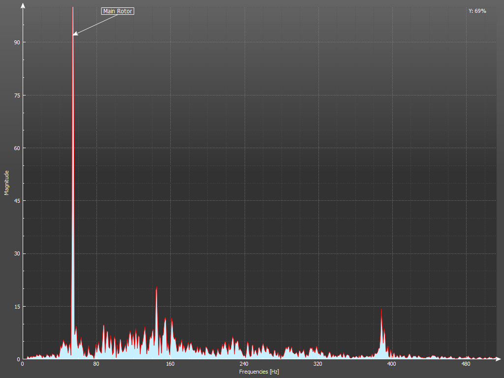

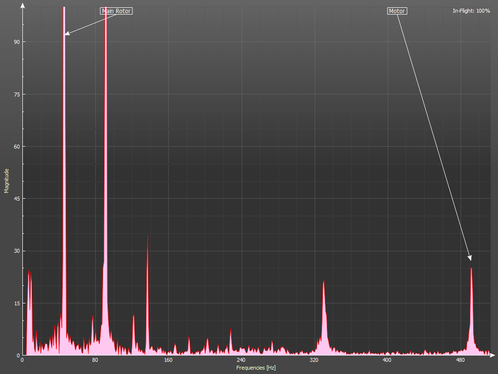

Replaced Main shaft, main bearings and main gear nothing left but the frame.
Still no rescue improvement. New Vibration files attached Y axis is without blades.

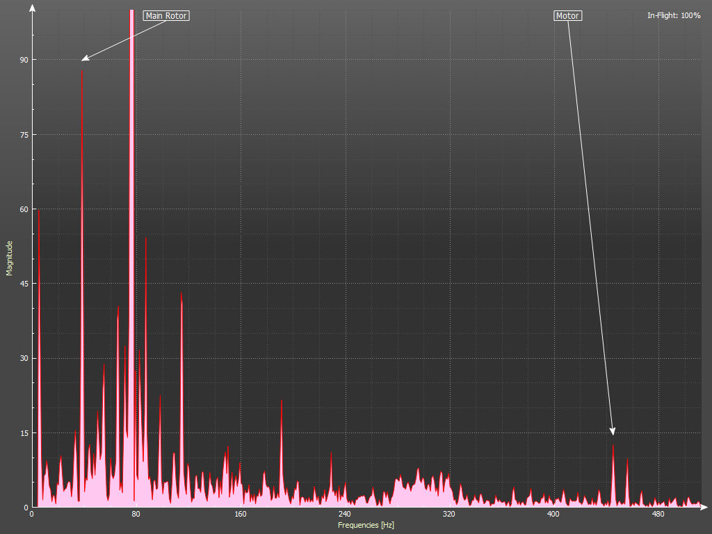

So here are new plots with new Aluminum and CF frame new main shaft and main gear.
So have a backwards rescue but level if I give full positive collective.
Still have vibrations without the head on.
At a loss what to try next !!
Posts: 12997
I would check if the motor and main gear is not too close or too far. Gears are usually not perfectly circular so this can cause a high stress too.
To reduce the vibrations you could try to balance the blades - some kits are supplied with some stickers for the blades - this could be a big issue. The higher the RPM, the bigger level of vibrations. So imprecise balancing could do a lot, even that it is that small model.
If you will be unable to make it work, enable the Extended signal processing in the Expert settings. This should reduce effect of the vibration.
Unfortunately this level is really far from good. 100% already mean, that screws can unscrew even with thread lock - this is actually quite common with the small helicopters.
